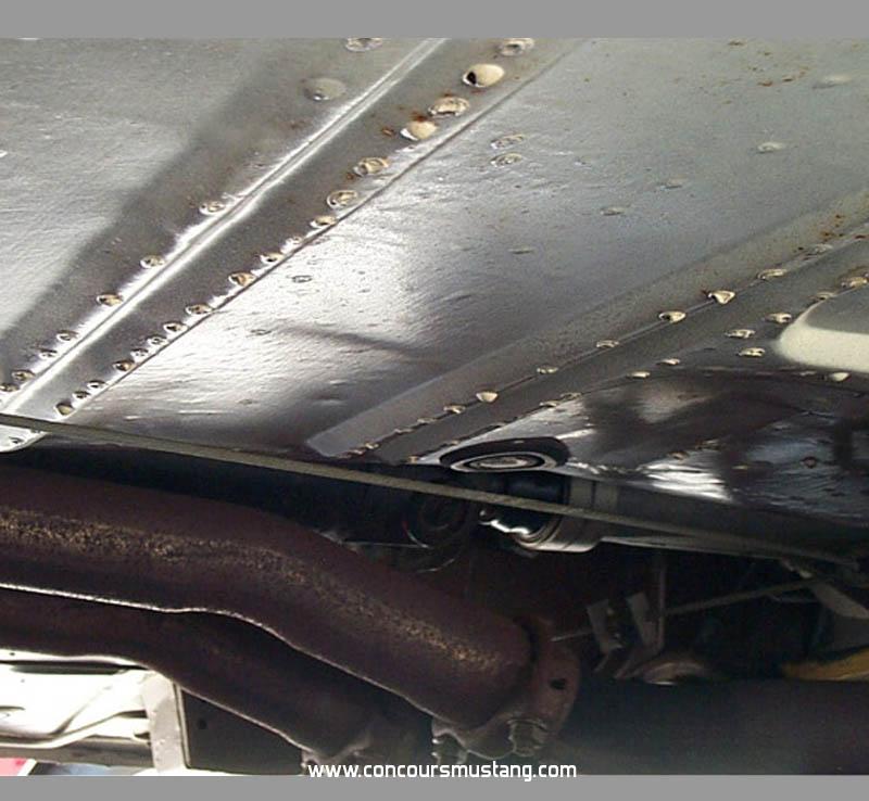

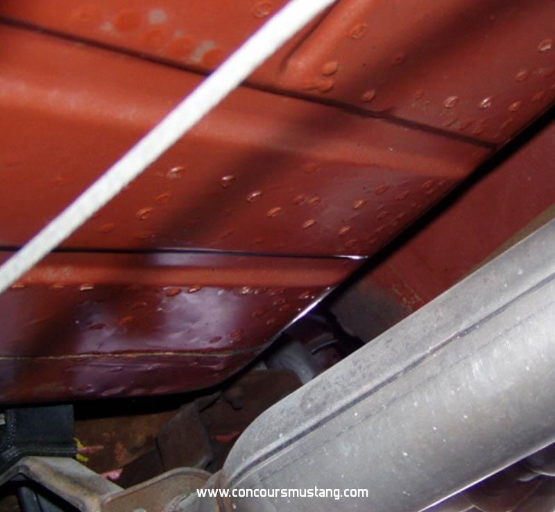

For 67 San Jose I'm not convinced that they are popped bubbles or collapsed drips or bubbles. Also not sure how air or fumes could have been produced inside a drip while not producing the same results in runs right next to these things. The reaction of the drips might be a result of exposure to heating lamps where the outer surface dried first then still not completely dry collapsed upward or the body was rolled causing this. IMHO knowing why isn't as important to us as how to reproduce the look on our restored cars though we do continue to try and find out how the process was done when possible.
Looking at San Jose examples I would report that maybe 40% of the drips produced these divots and in those cases 80-90% collapsed rather than what appears to be bursts shown on the 69 Dearborn example you have in the link. When they collapsed they didn't leave bare metal showing but sealed back up leaving often an odd multi-legged (for lack of a better term) pattern in the collapsed drip.
A few 67 San Jose examples - It should be noted that not all cars had as many drips or at the same location the pictures are provided only for discussion of the subject at hand
Passenger side front frame rail and outer floor pan
Typical drips collecting along the low points of the floor pan. In this example the ribs just behind a front seat
The rear floor under the rear seat riser. In this case the ribs are formed upward so the paint collected on the main floor surface here as well as runs on the seat riser panel since it is not perfectly flat
To the far right in the following picture you can see the runs that collected as the rear (under rear seat) flowed into the main floor section
Hope this helps.

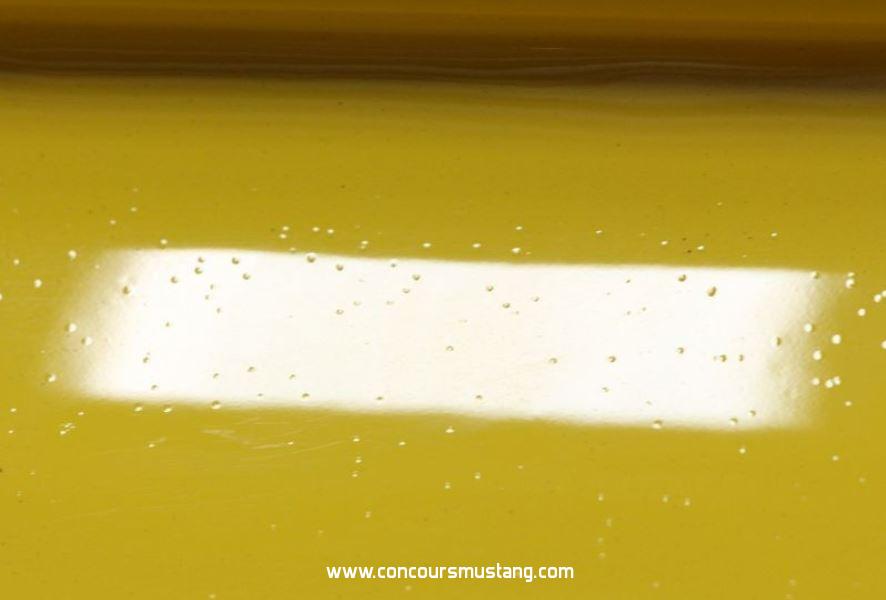

...I think it's solvent pop...
No, definitely not solvent pop. Solvent pop appears more like small pimples.

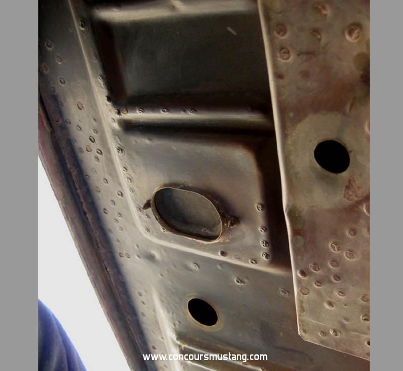

This discussion is of huge interest to me. I have about 30-50% (maybe more) of the original drips and many are popped yet many are not. I also think a good number of the lower portions of the underbody, were scraped off in an accident I had when I landed the car really hard in the open deserts of the Mojave once...front frame rails were wiped clean (for instance) and some of the lower ribs were also wiped clean of the drips. I wouldn't mind putting back what would be typical.

The undercarriage pictures are from a 66 GT Fastback I sold in 2005 (San Jose March 28 - sched). With the car on jack stands, I spent some time on my back cleaning. I made no attempt to remove any drips.
I agree that all of the recent paint threads seem to indicate that solvent pop is usually very small.
