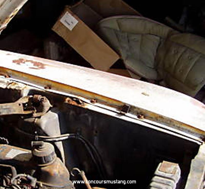

Best I can do with the grainy pictures of two cars close to yours is that the pictures IMHO suggest that the flat headed RSC bolts were not used on either of these examples and more likely used the same as what was being installed at Dearborn on non-Boss 429 cars during the same period.
Notice the shadow produced by the raised lip of the bolt head in these examples
9F02Z1586xx fender bolts
9F02Z16xx fender bolts

I have a January 30, 1969 assembled Boss 9 Z150XXX that has two types of fender bolts.
     -the two verticle by headlights are sunken head Flag Bolts
     -eight of the top fender bolts are also sunken head Flag Bolts (these are the same that were on my May 15, 1969 Assembled Boss 9)
     -there were four unique flat bolts on the fenders (two on each side very first and last on the fenders)
Hope this helps.
« Last Edit: January 02, 2018, 09:20:48 PM by Sean C. Gearty »
Re: 69 Boss 429 fender bolts
« Reply #5 on: January 02, 2018, 08:57:38 PM »
I have a January 30, 1969 assembled Boss 9 Z1504XX that has two types of fender bolts.
Hope this helps.
Have a mix of fender bolts on cars made just before the OP's car also (in the 9F15xxxx range)  which include the three letter flat style also.  Those appear to have found there way into the regular 69 production  at Dearborn at different times during the production year. Have them on fenders and spring cover locations

Those look like the RSC bolts. Interesting they are on the ends of the fenders only. For now going with the flag style bolts unless future information indicates they aren't correct. What I can see of your car looks impressive.
