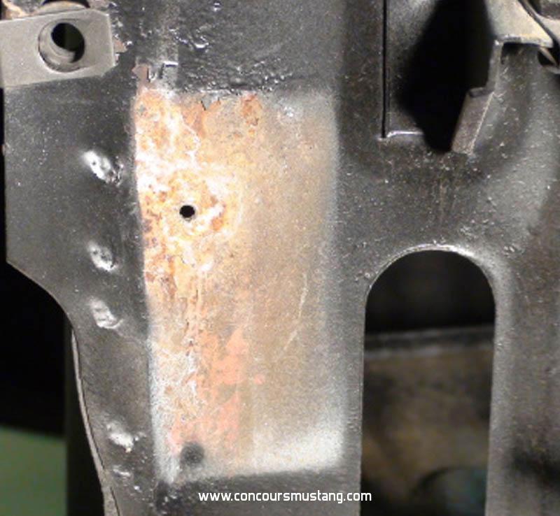

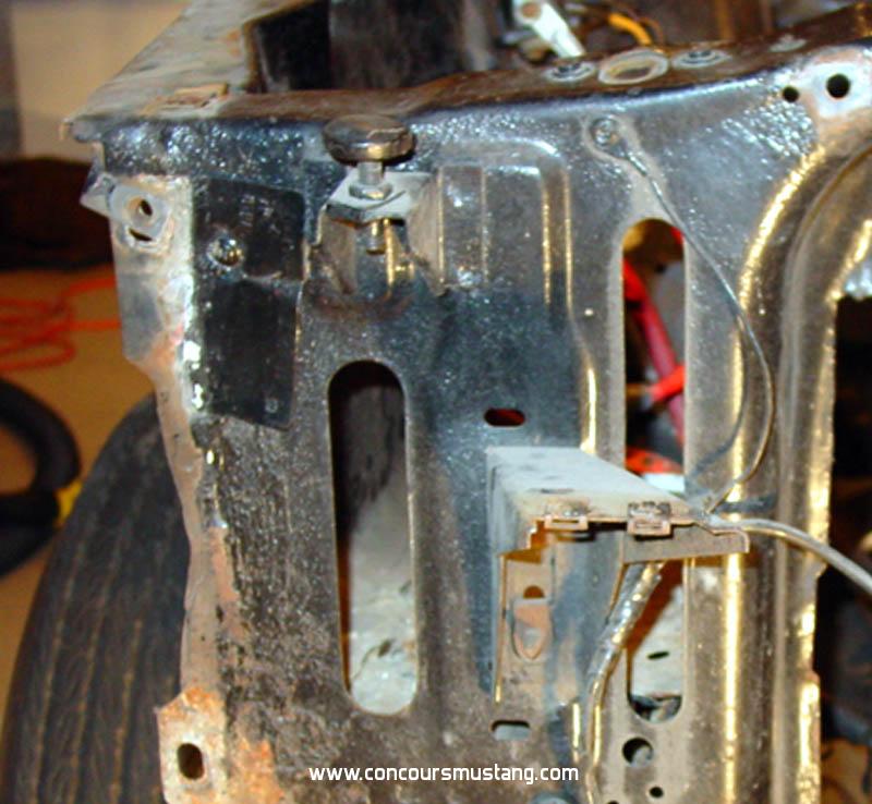

Lots of questions today  :) Will take car of the easiest first
Here is an example for the location (buck tag has been bent upwards to see) from 0F04F1022xx
One bent down as it would have been though it looks like it got bent at some point
They were attached to the radiator support before the black paint was applied to the area

Perfect Jeff, thanks, I looked at my rad saddle and found the tag screw hole, now that I knew where to look and have mounted the tag. I also found a picture in my files with the tag mounted, very hard to see it but that's exactly where it is mount tight against the hood support lug.
I have also found some explanations of the markings on the tag, and the author of that info indicated that the number on the top right hand side was the assembly line rotation number.
In your case picture its 210, on my tag its 057, but my rotation number is 519 according to my build sheet.

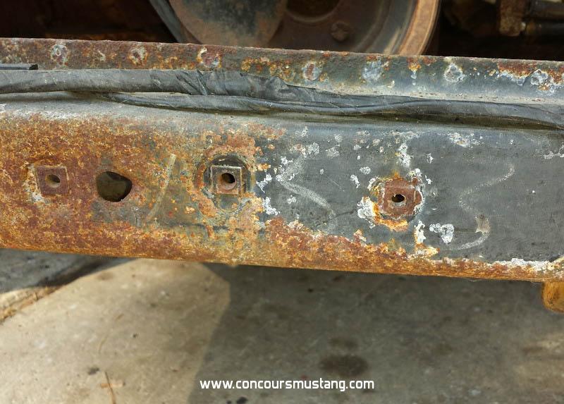

Re: Buck Tag Mounting
« Reply #5 on: January 19, 2018, 05:20:06 AM »
Another question, was the rotation number marked in say white paint or marker on the front of the rad saddle somewhere or on the frame below the rad saddle??
The second rotation number on a 70 Dearborn Mustang is often found on the front face of the front cross member at the lower hood latch support attaching whole. And example from early in the year  in white

Thanks again Jeff, I have that marking but it doesn't seem to match either of my rotation numbers, its hard to see but looks like  9 A X see attached pic

The 9 may be the last letter of what is left of your rotation number. The "X" is often a poorly applied "F" that disignated that the body was for a Mustang (seen it before at San Jose and Dearborn during a couple of years of production)  since the Cougars were built on the same line and from the front during a large part of the assembly its had to tell the two apart quickly and from a distance
"A" on you car is something new and likely connected to something that needed calling out to one or more stations down the line
