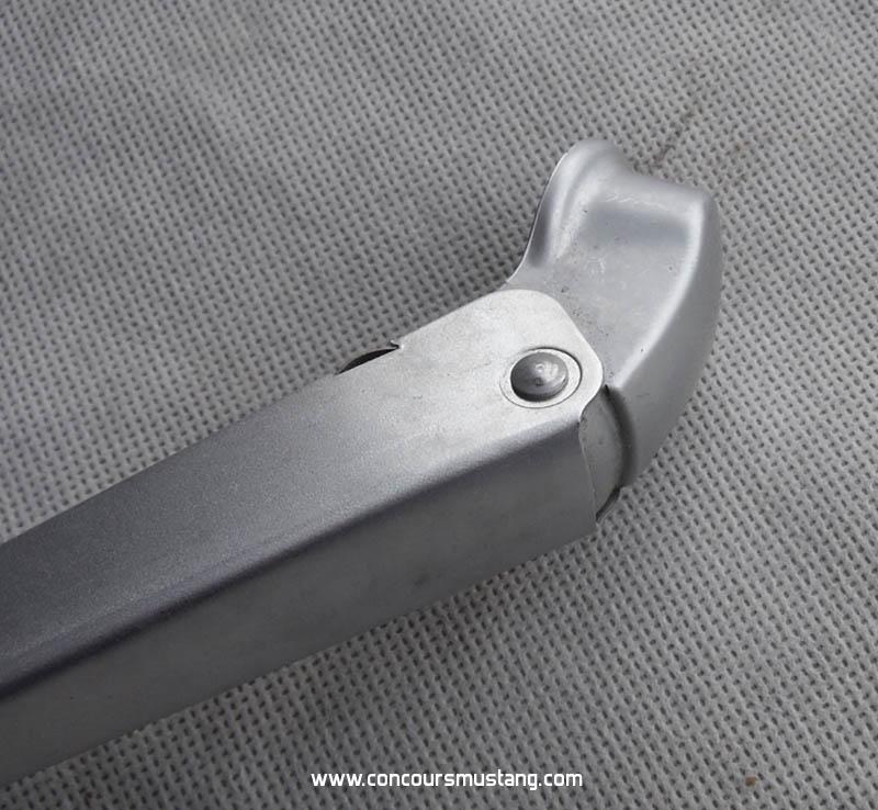

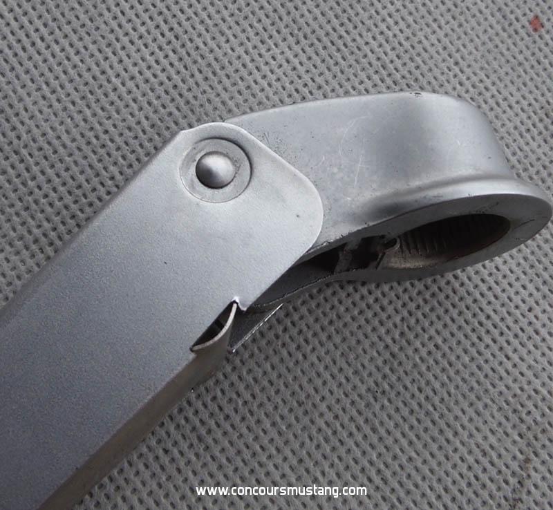

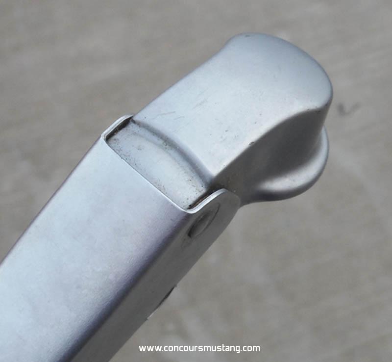

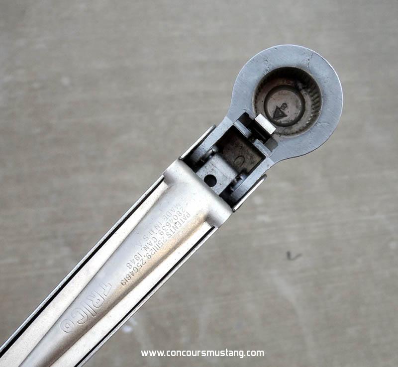

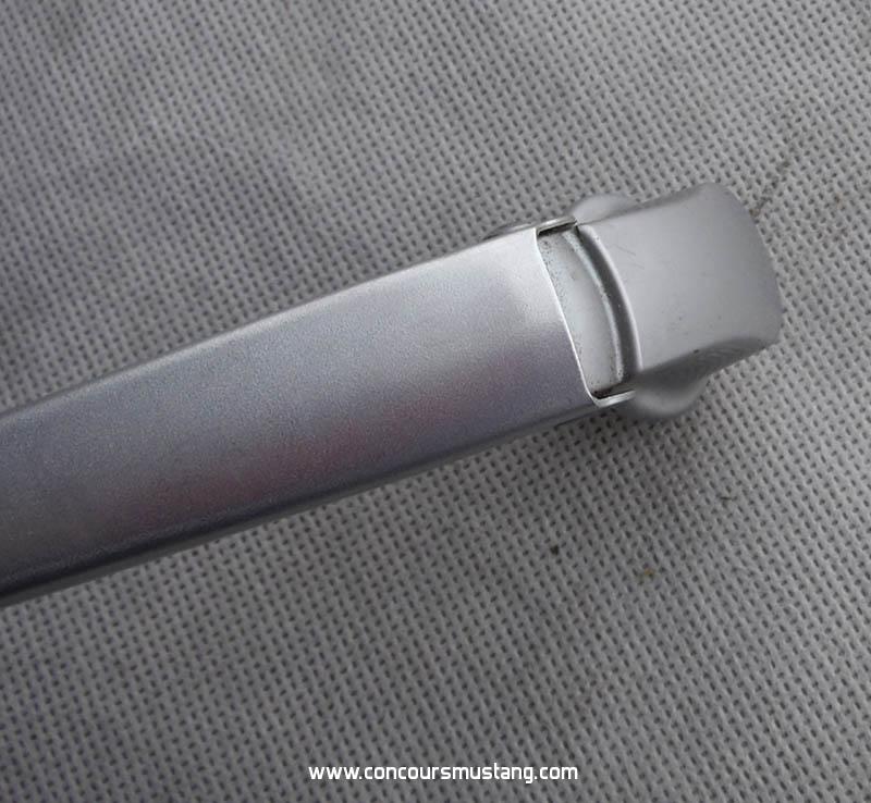

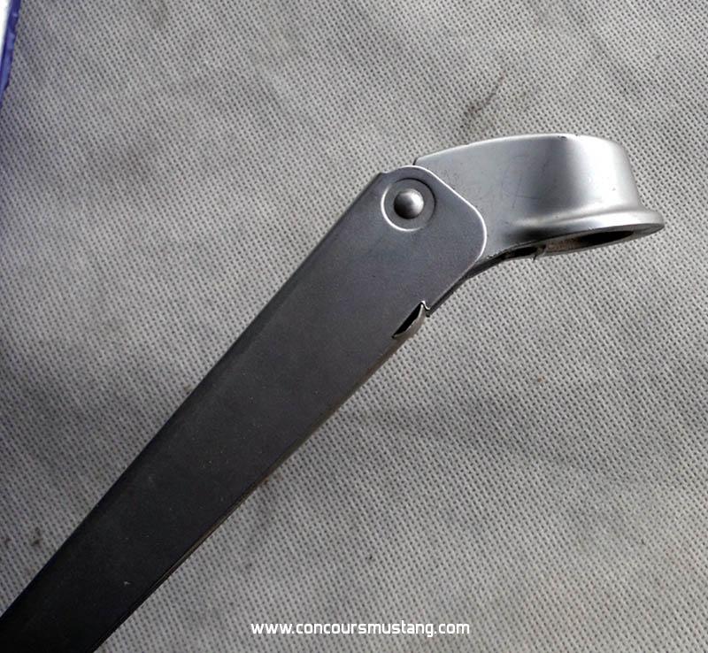

Thought I would add a few pictures of a service replacement/NOS to show finishes that had not been exposed to the elements or owners over time.  Every time I rotated it slightly for the pictures the arm and base looked closer or further from looking the same. All about the angles :) Yes all the same arm
WA-1
WA-2
WA-3
WA-4
WA-5
WA-6

The pictures WA 2-5 show the mid 68-70 style wiper arm. The clip on the bottom is curved .The assemblyline 65-mid 68 arm is straight. It is a detail that stands out when you are looking for it. You indicated that they were service parts which are typically later. If you compare the pictures to the other ones Jeff posted you will see the flat clip compared to the curved clip in WA 2-5

Sure one of us can dig out a flat style and post it to show the earlier style for comparison. Didn't have the time today  since those are all put away in round tubes
