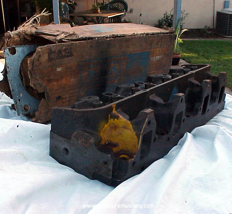

As mentioned each of the heads were produced with different number of exhaust manifold bolt/hole patterns. And there were thermactor and non-thermactor versions also
Since the focus is 67 S code here is a picture of a NOS C7AE-A (non- thermactor version) head I have
« Last Edit: January 28, 2018, 05:49:33 PM by J_Speegle »
Offline 427Fastback
  • Posts: 77
Re: S Code with a 2v intake?
« Reply #13 on: January 28, 2018, 04:25:40 PM »
Mr.Speegle is correct..Pretty sure that's the same head the 67 GT500 used.
Re: 67 S Code with a 2v intake?
« Reply #14 on: January 28, 2018, 05:50:50 PM »
Correct this was the same head as used on those cars if you add in the addition of the two versions depending on and indicated in the Shelby's VIN
