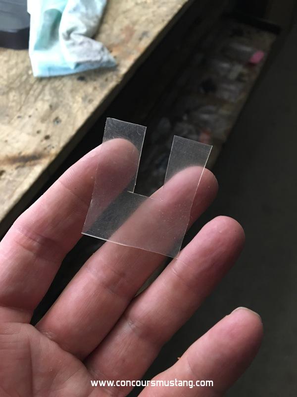

Many years ago I dug into a freshly primered fender with the fender/toothed washer bolts during some line up tests and decided there had to be a better way.
For my 65 mustang I dug out a coffee can plastic lid and rough cut some semi-squares and poked a hole in the middle.
First pic applies.
For the 67 I got a bit fancier and ventured into my wife's upholstery studio and borrowed her button press -- aka a circle cutter.
Once back in the shop I sourced a piece of wood and a small hole punch.
Second pic applies.
After a session with the Phosphate and Oil, I applied the protectors to be trunk lid bolts and now I'm ready to do initial lineup and final lineup.
Third pic applies.
Once you have the car painted, line up the trunk lid and tighten the four trunk bolts (each side). When you are happy, remove one of the bolts, remove the plastic washer and do a final tighten.
You can do this with the front fender, hinges and any other place where you don't want washer marks.
Ok, you can buy nylon washers. But why?

Here is the "Canadian" version. Everybody know Canadians are to lazy to remove the bolt to get the plastic washer off.  :o
