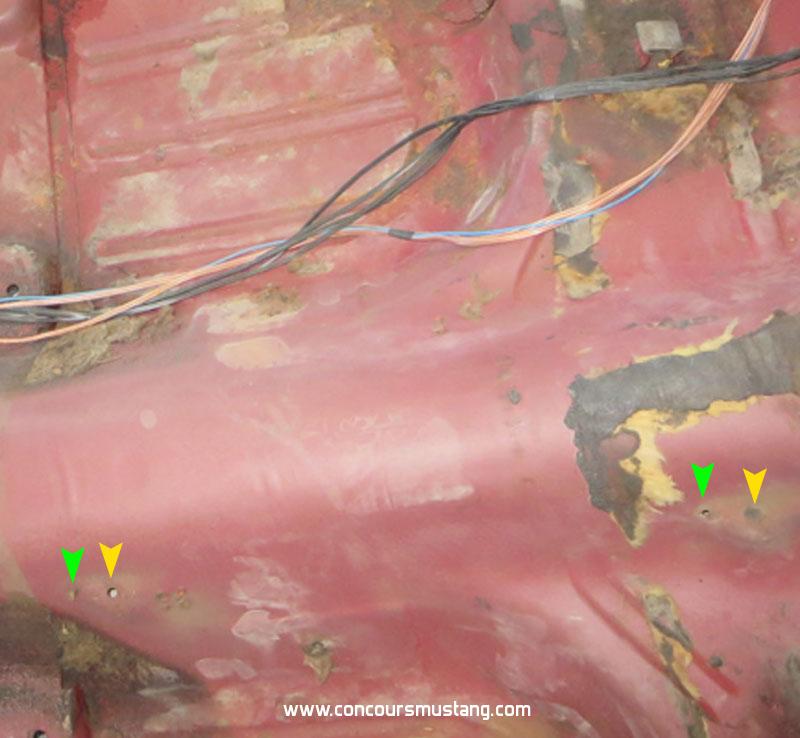

I am trying to figure out what the two small rubber plugs where for on the driver side floor hump of my 70 Mach1.
I have attached pics of these which I took during disassembly. I am also trying to source some new ones for restoration assembly.
Any help would be appreciated.

No to both responses, the screw holes for the brake line are beside the plugs please look at pictures, and no the car is an early built Sept 4, 1969 Dearborn built car.

Would it have been possible that these holes where originally designed for attaching the rear brake line with those clips that you press the center in like the one on the fuel line, and is it possible Ford or the assembly line opted not to use those and plugged them and put screws in instead to hold the brake line like the rest of the line?? It just seems odd that the screws are directly beside the rubber plugs.

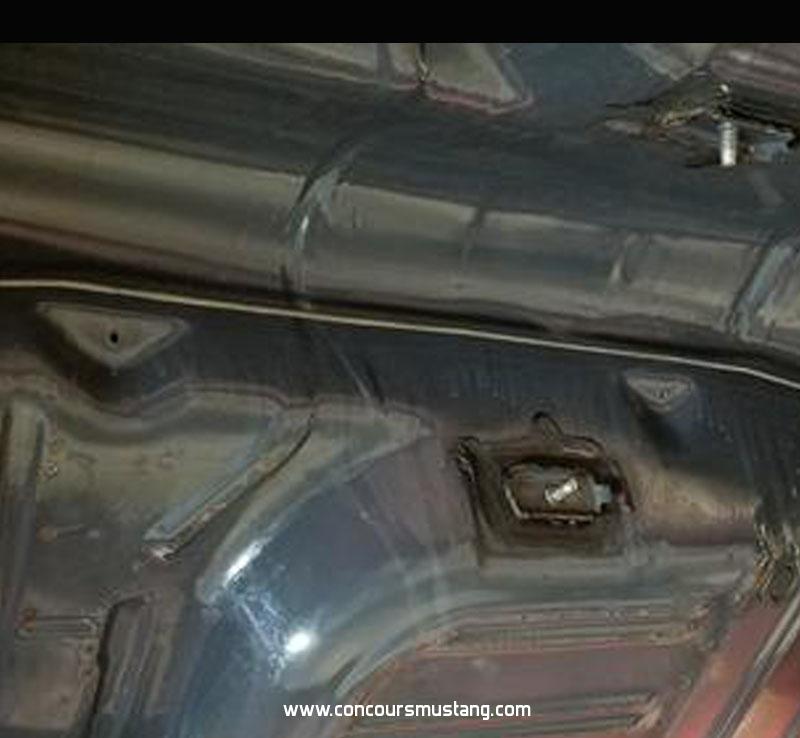

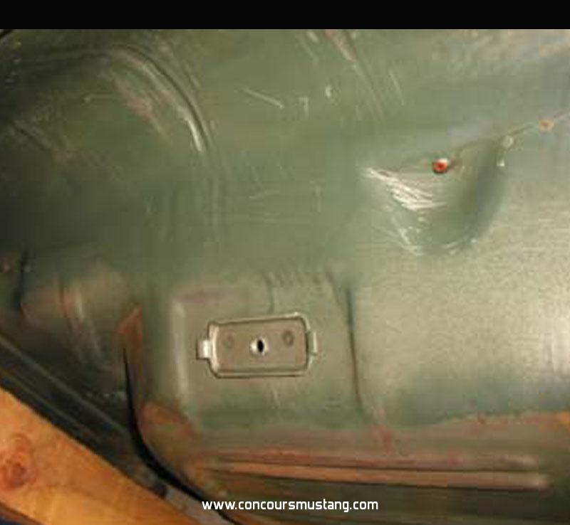

Went through my pictures and found the following for 70 Dearborn Mustangs
Single mounting holes were found from examples through out the year
There appears to be some short periods of time where and additional hole was made and used.
March example with no evidence of a plug like your example shows
Very very early example with a plug like yours
Not sure why the need for a second hole unless it was an issue with the size of the hardware the plant had ordered but there it is. Since it is a very short IMHO period the plug is likely something that was repurposed so you would need to remove one  and measure it to compare it with possibilities. Looks like one of yours is still usable (at least from the top look) and the other may be reusable since the top will not be seen. Not sure what the other ends of either look like

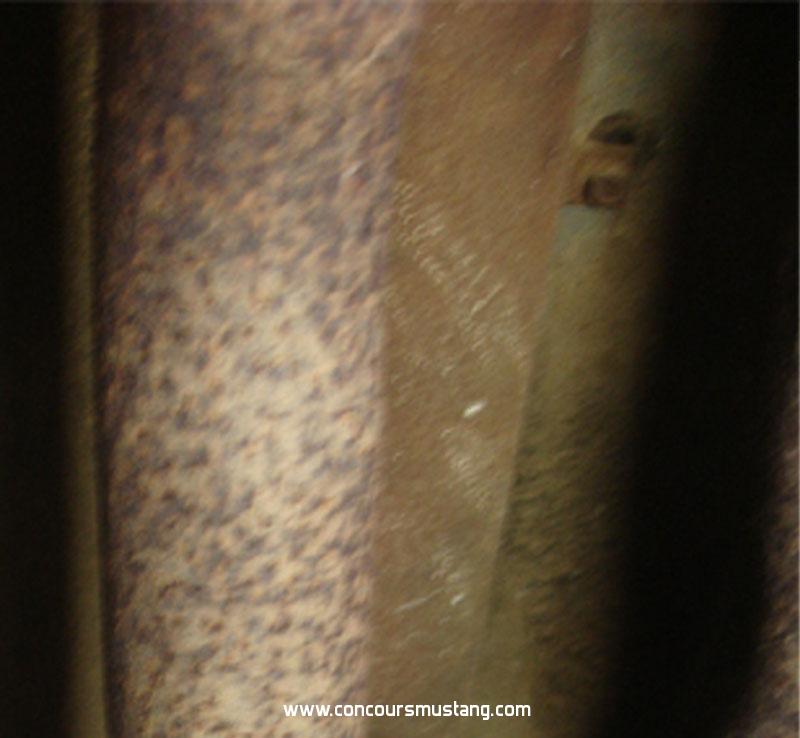

So to be clear my car was NOT built for the California market, it was built for Western Canada, Calgary Alberta to be exact. It also is a power disc/drum brake car.
I have attached pictures before restoration disassembly of the tunnel brake line and the clips used, and you can see both the screw/clips and the rubber plugs side by side in the pictures.
My guess regarding the screws not being put into the plug holes is because the plug holes are to large for the self tapping screws, so the holes where plugged off, and the clip/screws mounted beside them to hold the brake line. Additionally the factory clips are much different in size than the AMK reproductions as you can see they are shorter, heavier, with larger holes than the brake line dameter, and they are factory NOT replaced during the previous owner life of the car. The longer/lighter AMK style clips where originally used for the one in the tranny hump and the firewall area, but along the driveshaft hump they where short as shown in the pictures. I think the general discussion regarding this topic has evidenced that the holes where for push clips as I suspected and Jeff alluded to, and they where never used and just plugged off. Thanks for the input and discussion regarding the topic
