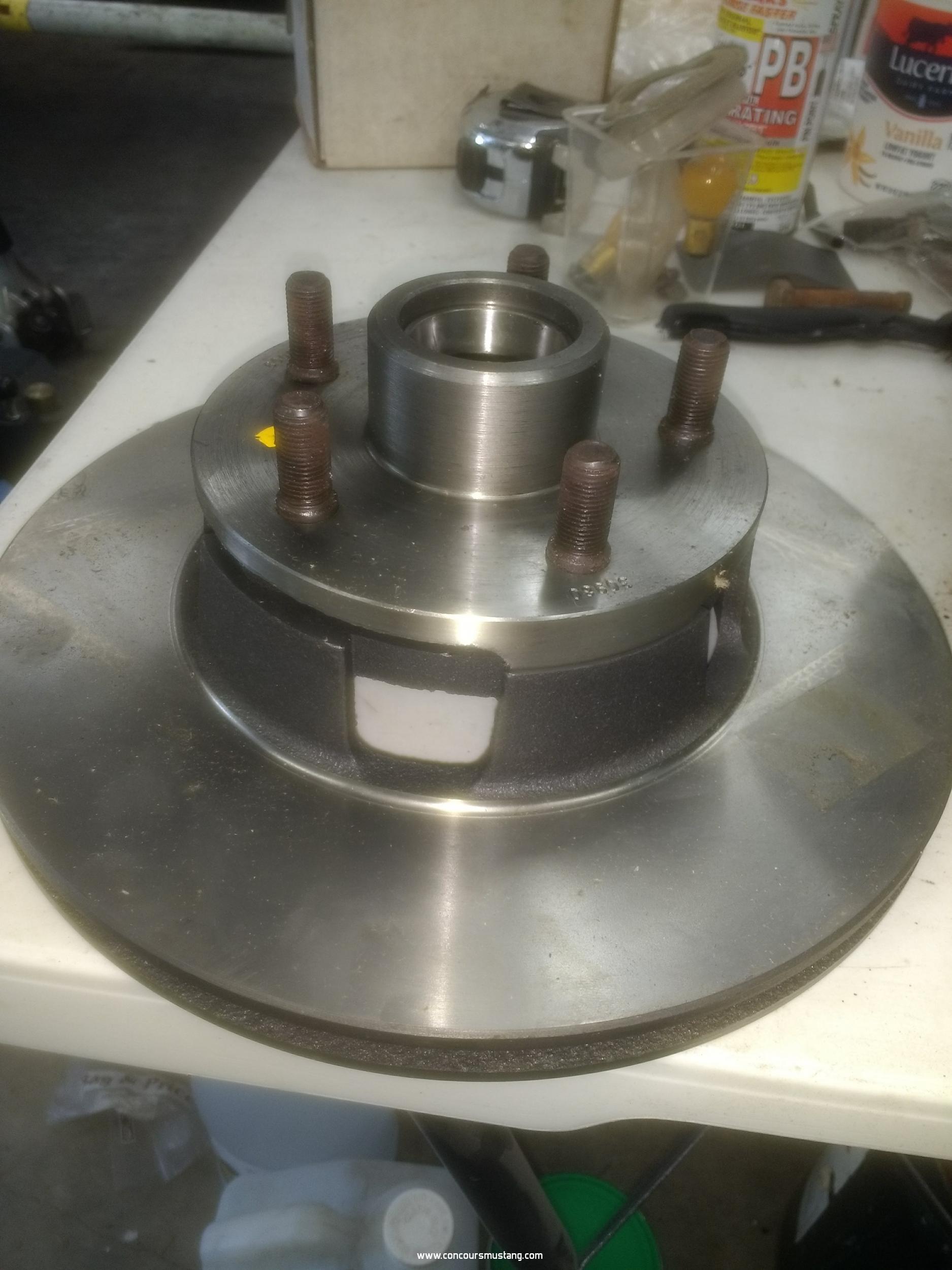

Those look original to me, notice who the vertical wall where the cap the grease cap is isn't straight on the hub (service replacements we all a clean line)  and also on the back side of the picture you can see the notch cut out of the hub, this look like original Kelsey Hayes to me... at least the hubs do...
Jason
Agree, Hub has different design what fits through the hole in the wheel, also, the KH hubs have that notch and a hole that the Century or Ford service replacements do not. Also typical, the letters K/H on the back sides of the studs.

Sorry for the lousy pic. I was drilling in on the window and the cast flash in there, but you guys are mentioning other things! Plus the thing is heavy and on an upper shelf,
Here is a top view of the hub.
And another of how the rotor was balanced by welding a u-shaped piece of steel into the vanes.
I thought of Centric (brakes) when I saw Century in the other thread.

Bill, yes, your hubs have the characteristics I have seen on the assmblyline Kelsey Hayes rotors. Two items NOT confirmed yet is the view from inside (spindle side) of vanes looking outward. You should have the staggered vanes if original. That and the K/H wheel studs ;)

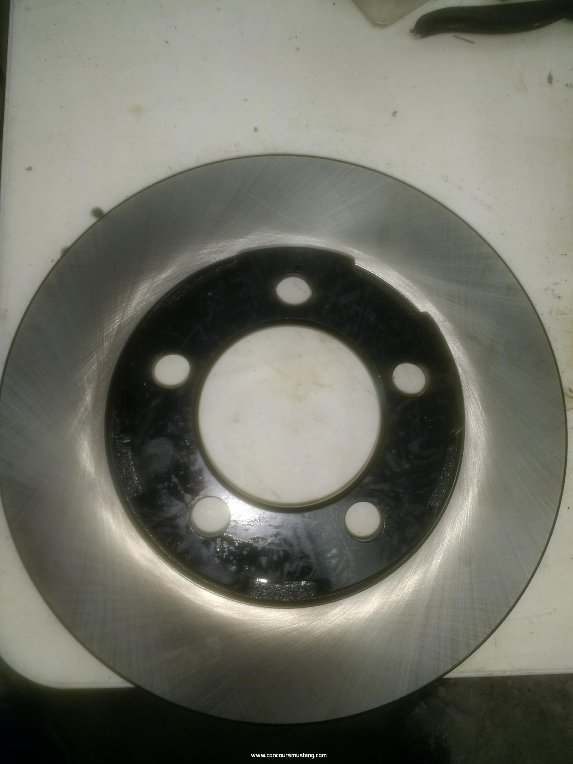

Here  are some pictures of the Centric 125.61053 rotor I just received from RockAuto.
You be the judge as to whether or not this is a suitable replacement. IMO I think these are great.
Two issues, though.
 The casting is much smoother than stock --  that is apparent.
The vanes are inset a bit more than stock.

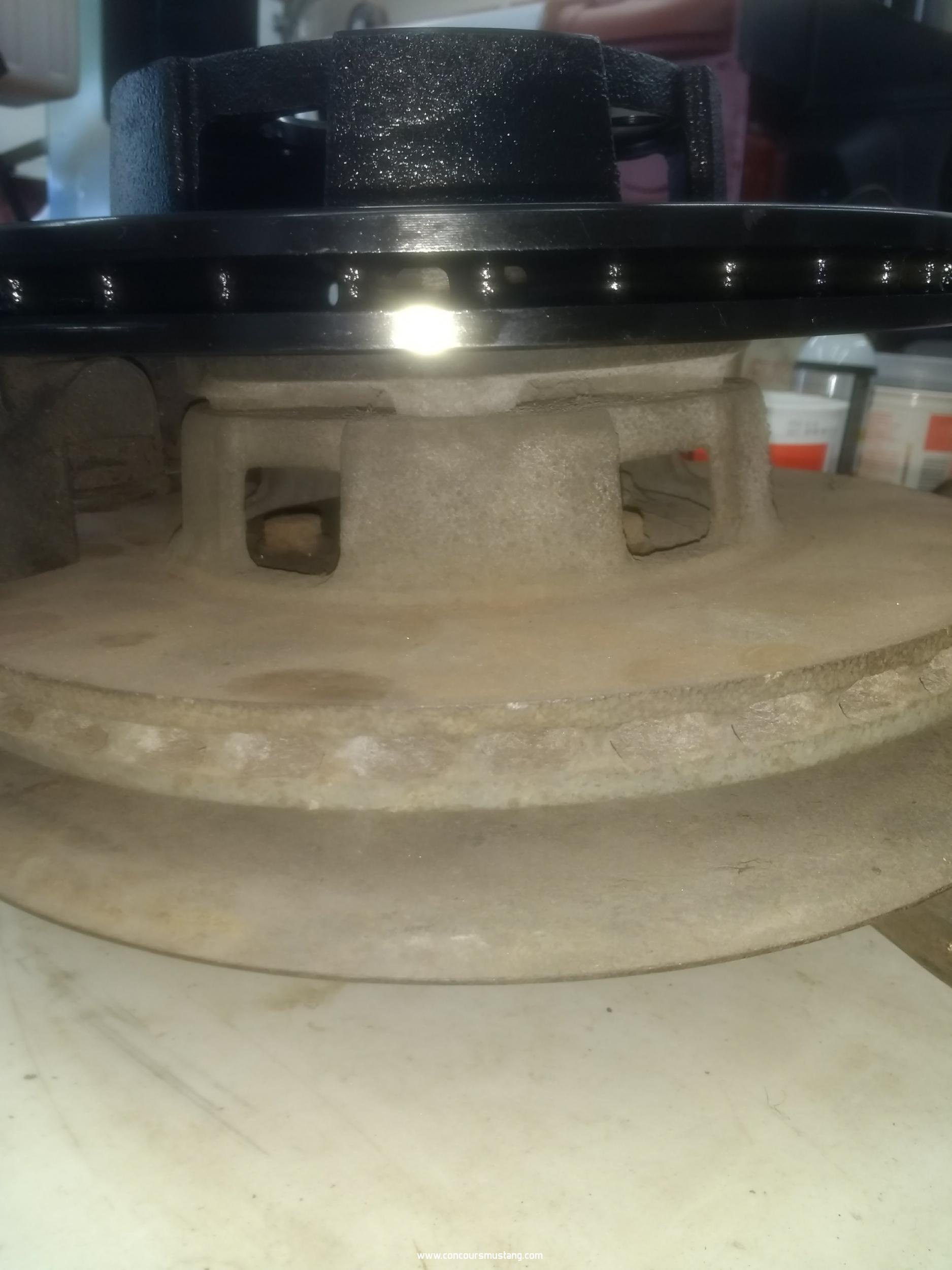

An original hub and rotor with the Centric laying on top of it.

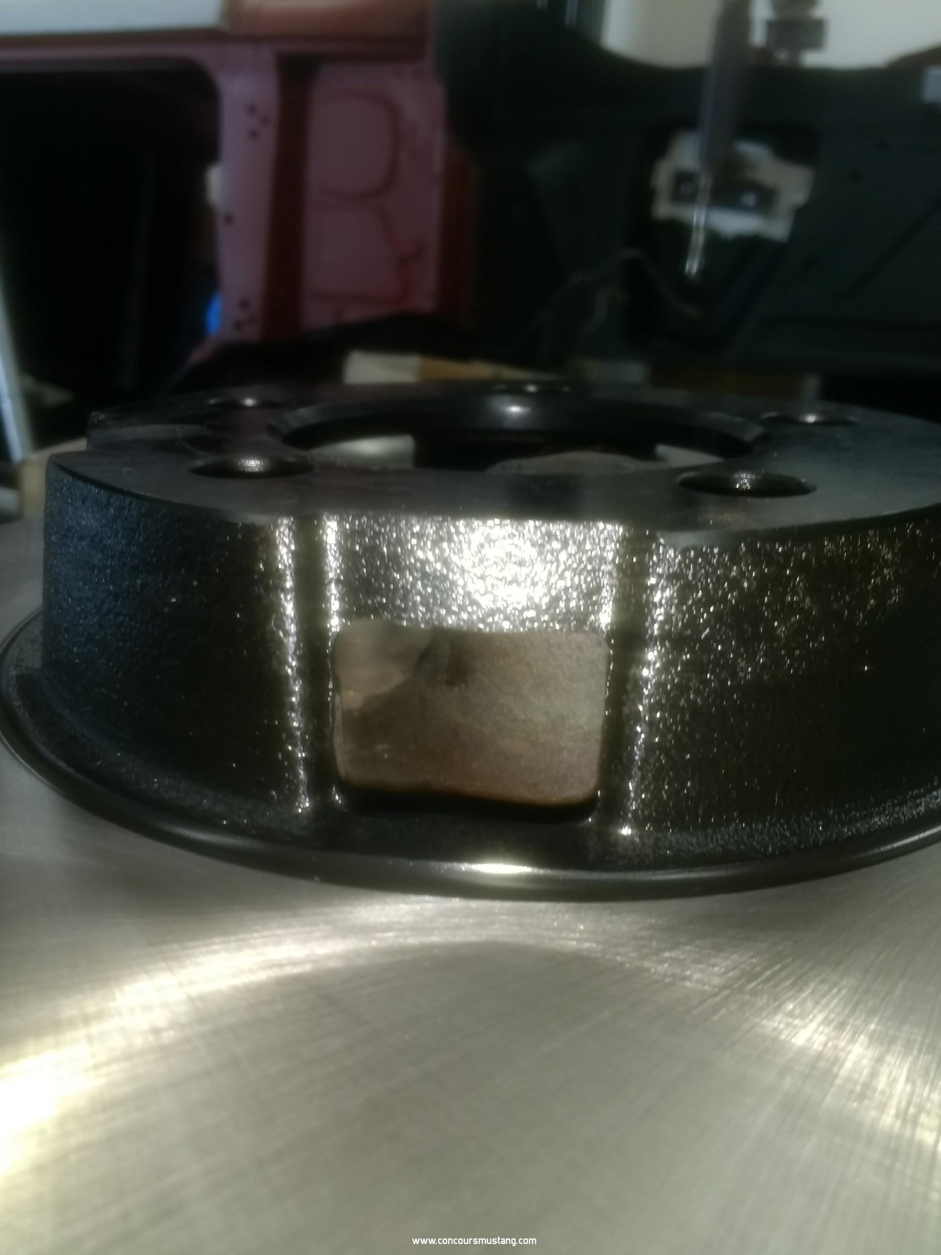

Closeup of Centric window.
Backside of Centric.
Closeup of the inside of the Centric window.
Two issues, though.

Without seeing the finished product I hesitate to give a definitive ruling of what I would do in Concours trailered or SAAC DIV II judging. Getting rid of the odd shade paint and with a properly detailed hub you should be able to get it to look as good as the Raybestos rotor. Any other non assemblyline details in this regard would most likely be in the mention category and not in the deduction category. Just my opinion others may have different.
