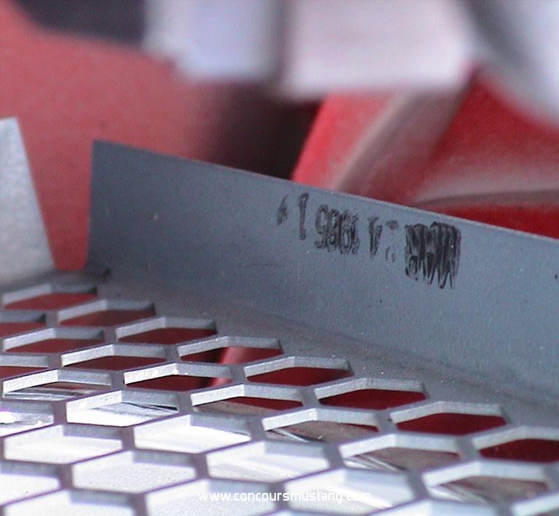

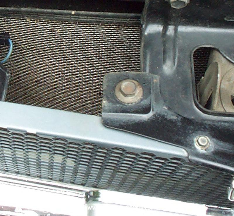

« Reply #12 on: February 16, 2018, 11:11:35 PM »
Three examples from very nice original cars, grill with original paint on them,  built at Dearborn.
Before  - within 3-4 weeks and after the date you posted
Contrast between the grill color and the black items in the pictures are apparent
Surprised how close they look on my monitor given that they were taken different days, different cameras under different conditions
Believe a number of the major parts houses have their version in rattle can. You would have to ask those that have used any of them how close they were
Don't forget the details ;)

« Reply #13 on: February 17, 2018, 03:07:42 PM »
@ J_Speegle.... Thanks for the effort and post.
Good pictures.  Dearborn on Mar 24, 65.  Mine at Dearborn on May 14, 65.  About 50 days apart and they look the same and I think verifies what mine should be.
