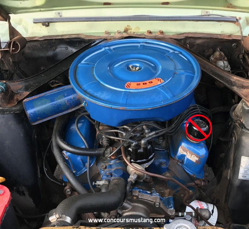

The air cleaner I'm finding installed at San Jose on small blocks without Thermactor would be the one where the base only has the opening for the snorkel and not the two other nipples at the front and rear of the base.
To explore deeper though does your Marti report include a comment/option about closed emissions?  And as long as your checking things your DSO might help assure details
The breather would be the flat without nipple painted semi-gloss black. You made no mention if the car was a Sprint so going with what you posted
Couple of examples. Not great unrestored cars but they do offer the details we are focusing on at the moment
Appears to be the original shape of the open emissions breather

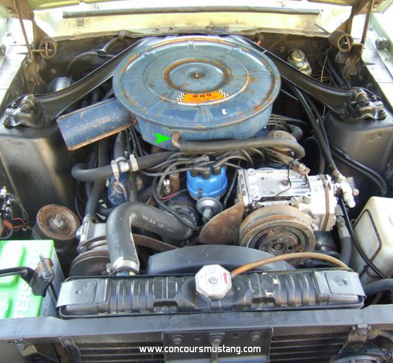

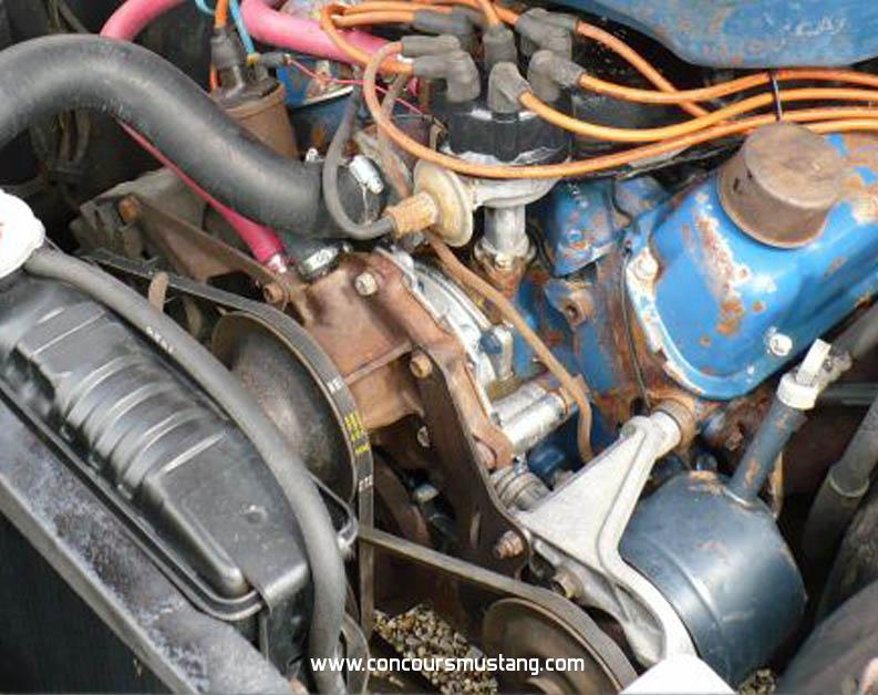

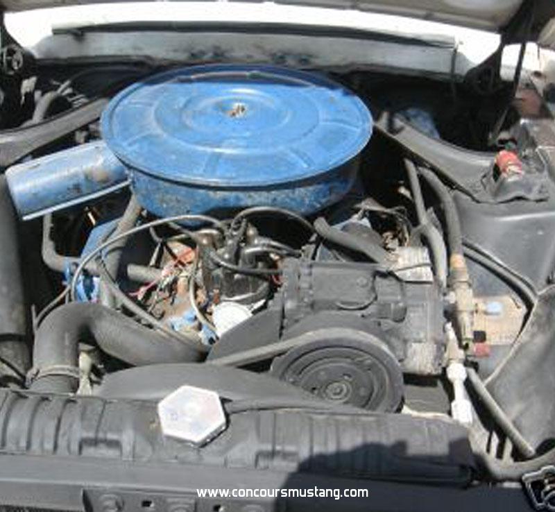

Let me add some info to the mix. Here are some San Jose air cleaners bases with a view of the rear. Note the plug.
Another picture of an early, I assume, air cleaner with a tube fitting for the choke pre-heater on the manifold (red arrow). Note the tube on the front. I believe the color for this should be gold. I can't verify VINs, but most of the cars I've had access too were San Jose built.
Mentioned the rear thermactor hook up nipple in the first response.
"not the two other nipples at the front and rear of the base"
Have not seen a 67 small block with the small tube hook up that I can recall.
Were would it attach to. Two years later of different engine had a similar connect but that only lasted a few months before they dropped it.
Would not surprise me if San Jose installed a Thermactor base and plugged the front and rear nipples but it IMHO would be unusual and not something I would do if I didn't have what I considered the original air cleaner
Considering that it has the add on ring (as they did on non- Mustang 390 air cleaners) could that be a non-Mustang application. Believe there is a mention on the second to the last page of one of the 67 Shop tips discussing air cleaners and the additional ring.
Just my thought given the picture
