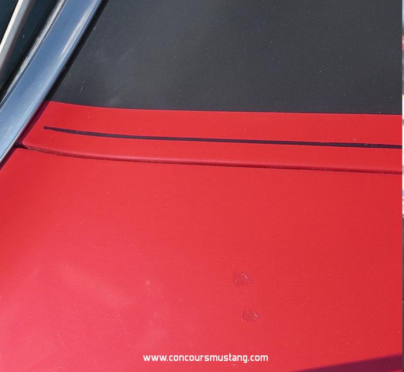

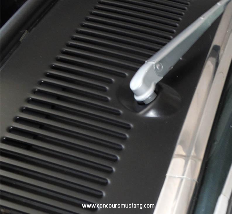

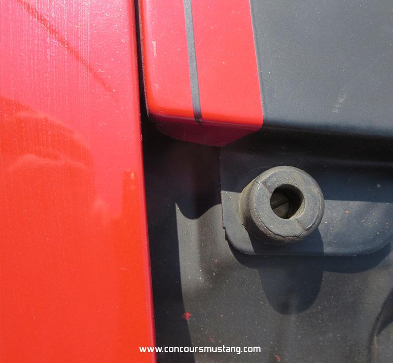

We never "talked" about when the car was built. Hopefully that does not have a great bearing on how things were done. At this point it doesn't appear to
Two original paint examples at least one of them was featured in an unrestored picture thread. I invite to search that out since it might help in some of the differences between San Jose and the other two plant production practices ;)
9R1359xx  a Jan built car
Notice how the outer stripe stops well before the windshield molding. Not something you see on the typical "restored" car
Wiper post
Cowl to hood opening
9R1705xx April built car
Again stripe stops well before the windshield  trim

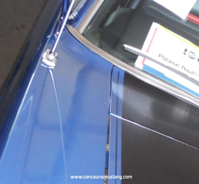

Looks like this time the worker went further to the edge. Does not look like he placed the tape barrier (which forms the slight T in most of those stripes at the very end) this time and free handed this one time. Example of the slight "T" finish detail can be seen in the third picture above of the blue example

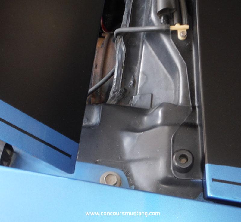

I believe the hood and cowl blackout  were painted off the car. The pin stripe was applied after the hood and cowl were fitted to the car. Notice in pictures the cowl black was applied prior to molding installation. I have not seen black zebra striping on underside of cowl or overspray on wiper parts on unrestored 69 cars . The reason the pin stripes end before edge is the moldings and hood were already installed. The jig that guided the stripping wheel was not the same as blackout template. Often the hood and cowl blackout does not line up on both sides ,however the pin stripes do line up well because they were applied after assembly. If you have a good example to observe you can notice the difference in black paint and overspray pattern between the removable cowl panel and the area below the cowl and see there is no way the cowl was pained on the car. My reference is Metuchen and Dearborn  Mach's and Boss's. I doubt San Jose was much different from pictures used as reference in earlier post.

When looking at the pictures that Jeff and Bob posted, the unpainted area on the cowl panel must have been at a different width when you look closely at the bottom tab that the mounting screw goes through.

The angle of the picture and the difference between the way San Jose masked that end compared to the late Dearborn way that Bob showed in his example may tend to produce a optical illusion.  The gab (short of measuring them in person) between the end of the cowl cover and the edge of the black out looks pretty close if you just compare those IMHO
Appears that San Jose ran the masking tape at an angle on the two examples I posted.  Will have to see how many other Dearborn examples I have that show that detail in my files. The other side on the example Bob posted looks different from the passenger side he posted the picture of so should look for some more examples for Dearborn owners and also just to see which side was more the nor for the plant but of course that is not the focus of this particular thread
