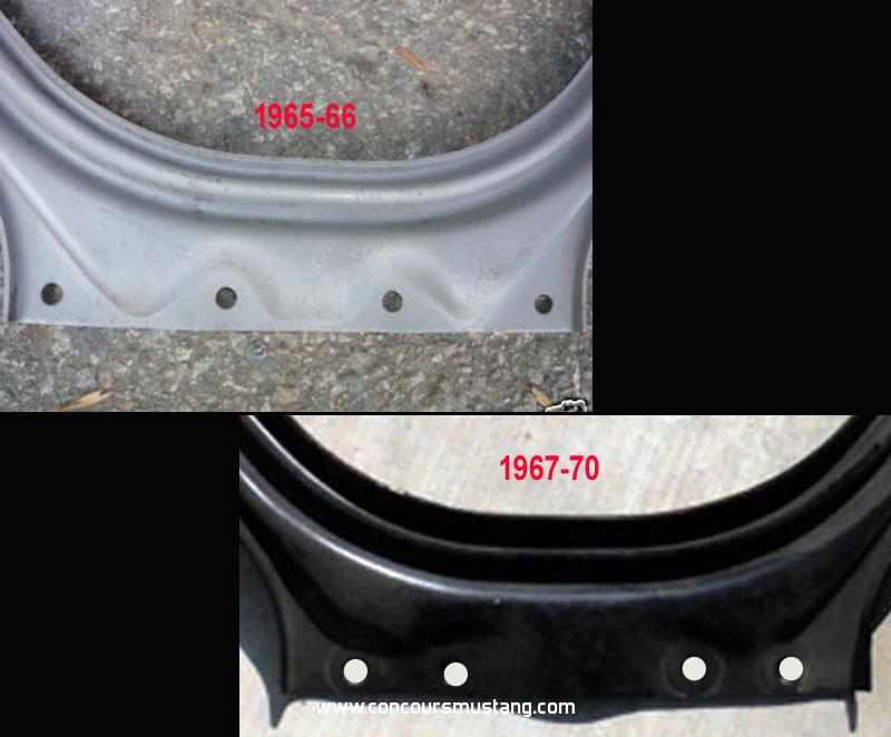

Post some pictures and we should be able to settle on what you have . A shot from above showing the entire brace and a shot turned on edge for a side profile. Some originals had the small holes and some did not.  I have not seen 4 on one side before. There is still the matter of if a 65/66 version or the 67/68 version .

Haven't seen any with four small holes in the support arms not have any pictures of original with that many holes. Possibly added and not a confirmation of an original. Some originals have a single holes located in  the forward most "dip" midway in the passenger side support arm
Agree that it would help for us and in the future if you would identify if yours is an early (65-66) or later version. Note: the finishes on the early brace is not original ;)

Export brace holes location.
