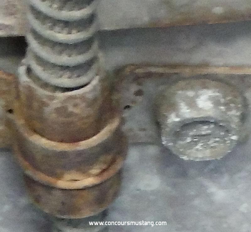

I'm wondering about the parking brake cable bracket and bolts... I assuming the finish is natural for both of the brackets themselves, but read somewhere in one of the threads that one was painted and one was natural, but maybe they were talking about something else. Also, was there any head markings on the four bolt heads? I've attached a picture for reference of the brackets I'm speaking of.

Hey Jim, did you have any head markings on the bolts? Mine were so badly rusted I couldn't make out anything.
Jason
Yes there were typical markings
This example is from a little later in the production year. Looks like the often seen diamond IMHO

originals from my 66 Jan NJ

1966 San Jose, Build date Dec. 1, 65.
Can't make out the head markings. Can you describe or confirm they match others posted for the record :)
Looking at a higher res version of the images I have it looks like a D, but I could be wrong. I can try to look when I get a chance.
I can tell from the picture posted that it is a "D". The brackets appear to be restored (cleaned with slight pitting). I think the diamond would be more common for SJ through 66 IMO. I am skeptical that the "D" hasn't been switched out but can't rule out the "D" marking. If I wasn't absolutely for sure that it was original hardware I would go with the more common IMO diamond if it was my car but that is just me. Good Karma for the effort of posting pictures regardless.
