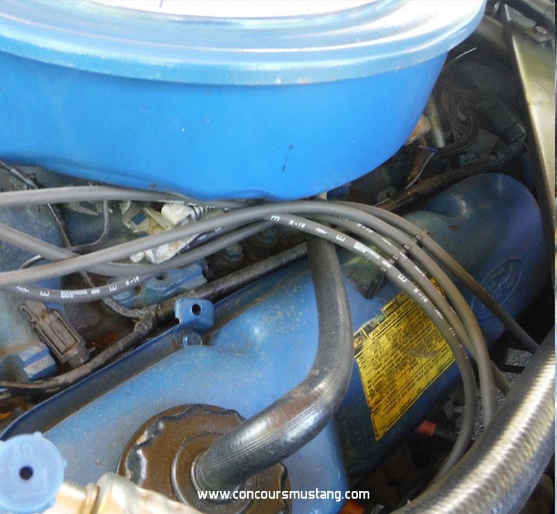

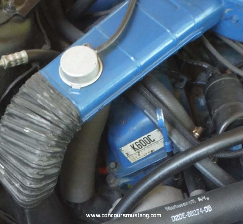

« Reply #1 on: May 19, 2018, 05:20:57 PM »
Using the search feature I found the pictures in the following earlier posts ;)
Search is your friend
http://www.concoursmustang.com/forum/index.php?topic=7504.msg42694#msg42694
http://www.concoursmustang.com/forum/index.php?topic=3728.msg20282#msg20282
Thought I had posted a thread with pictures of this example also but can't locate that thread at the moment
http://www.concoursmustang.com/forum/gallery/10/6-190518161943.jpeg[/img]]
http://www.concoursmustang.com/forum/gallery/10/6-190518161958.jpeg[/img]]

Thanks Jeff.  It is blue as I expected.  I have been using the search option more lately but spaced it this time.  Mark
