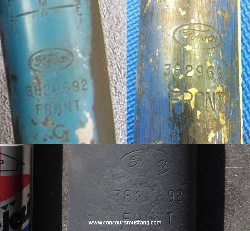

« Reply #3 on: June 30, 2018, 10:59:23 PM »
thanks bob
any part numbers for either fomoco or koni’s so i can do an interenet search?
The rears are stamped with the FoMoCo in an oval and the number under it is 3829394
Fronts have the same FoMoCo oval with 3829392 stamped in the side/tube
Don't think any are going to turn up using the engineering numbers but good luck
Have not seen a set for sale or advertised in a long long time.

This is a delayed reply but I just saw it. Instead of 3829392, my front shocks are 3829396.

Interesting - So this is from a pair of FoMoCo stamped adjustables. What is the date code if you would?
Have pictures of 5 pair of the fronts ending 92 would love to see yours

+1 . I haven't seen any adjustable shocks with that number .
