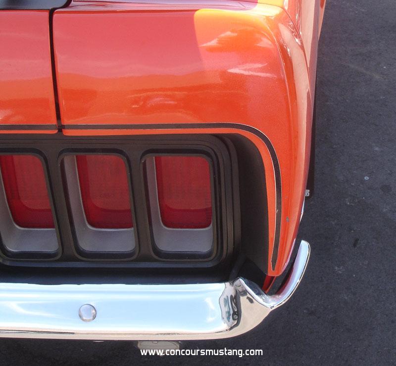

This has been one of the most frustrating items in the restoration of my car. One bezel required three complete paintings before I was happy with it!
As you can see in the pic, the black covers the "lip" of the opening.

Doug as I did the exact opposite of you and paint the ARGENT 1ST, THEN TAPED OFF THE ARGENT SINCE THERE'S A LIP TO USE AND SPRAYED IT WITH SPRUCE 38-88 BLACK ( MATCHES THE SEMI-GLOSS 1613 TO A SPOT ON COLOR, LET IT DRY AFTER 24 HRS AND MASKED OFF THE ARGENT, SPRAY THE BLACK SPRUCE AND THEN AS A FINAL COAT USED VHT SATIN CLEAR FOR A COATING SO  PAINT WOULDN'T CHIP AND LOOKS REALLY GOOD- PICS ATTACHED
