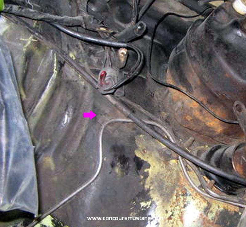

Need picture of clip and fastener to lower firewall near steering column. Thanks. I have picture of cable attached to floor pan.

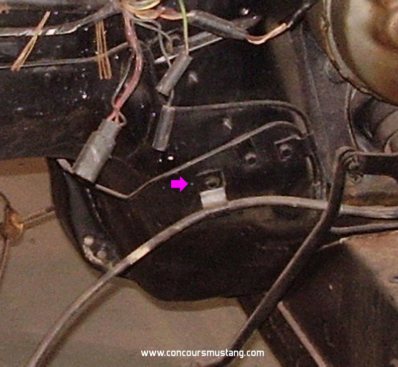

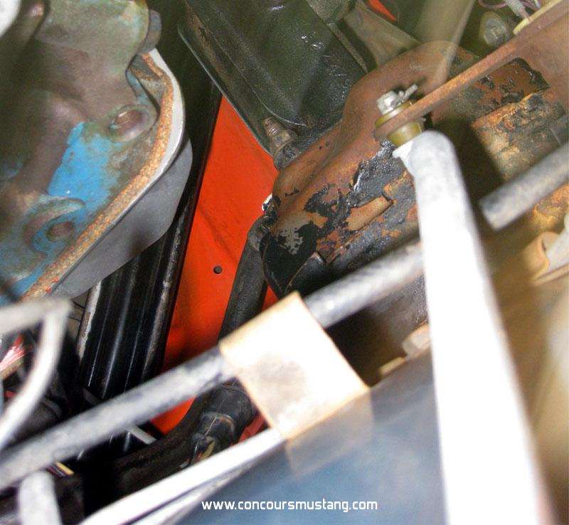

Couple of pictures. Not an easy spot to find a picture of especially if the engine is installed   ::)
70 Dearborn
0F02G1427xx
Another 70 Dearborn (0F02G1815xx) example with the hanging style bracket
70 NJ
0T02G1680xx
Appears to be different locations, attaching orientation and maybe different bracket but will look for my examples
