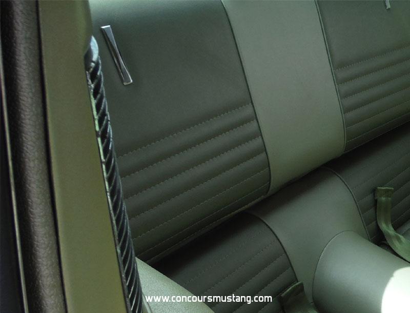

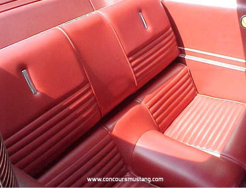

Pictures to help  :)
Re: 67 deluxe interior seat ornament
« Reply #4 on: August 26, 2018, 08:34:34 PM »
Yes please  and thank you, I tried to post original  seats and the metal tag underneath  the seat webbing  I believe  the seats  have never been changed, oh well an  other 67 anomaly
As you can see from the pictures that Jeff posted they are centered vertically and horizontally in the area above the pleats, so dimensions not really necessary.   I just looked at mine and they are very buried at the moment...but I do have a parchment comfortweave one in the garage attic, that would be more handy...be right back...ok I'm back.  Picture 1 shows that the center of the "button" is 8-1/8" measured horizontally from the nearest pleat in the center of the seat cushion.  Picture 2 shows that the center is about 3-1/2" from the pleat directly below the button.  I suppose that a non-comfortweave might be different than the solid material, so use these only as a sanity check please.

These sometimes get left off when the seats are recovered
67gta289 the measurements are very helpful now and for others that will check out your post

I stand corrected. My memory failed me.  See the attached picture.   It looks like backing plates are part of the deal.
