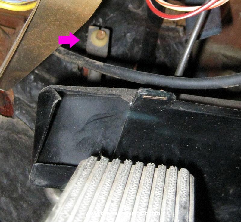

Re: 70 gas pedal help
« Reply #6 on: October 07, 2018, 05:04:30 PM »
Found a picture of one - well at least the top attaching end. :)
Different from the 69 version.

Thanks Jeff it is a bit different from mine.
