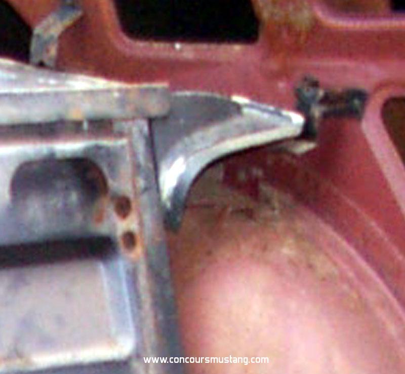

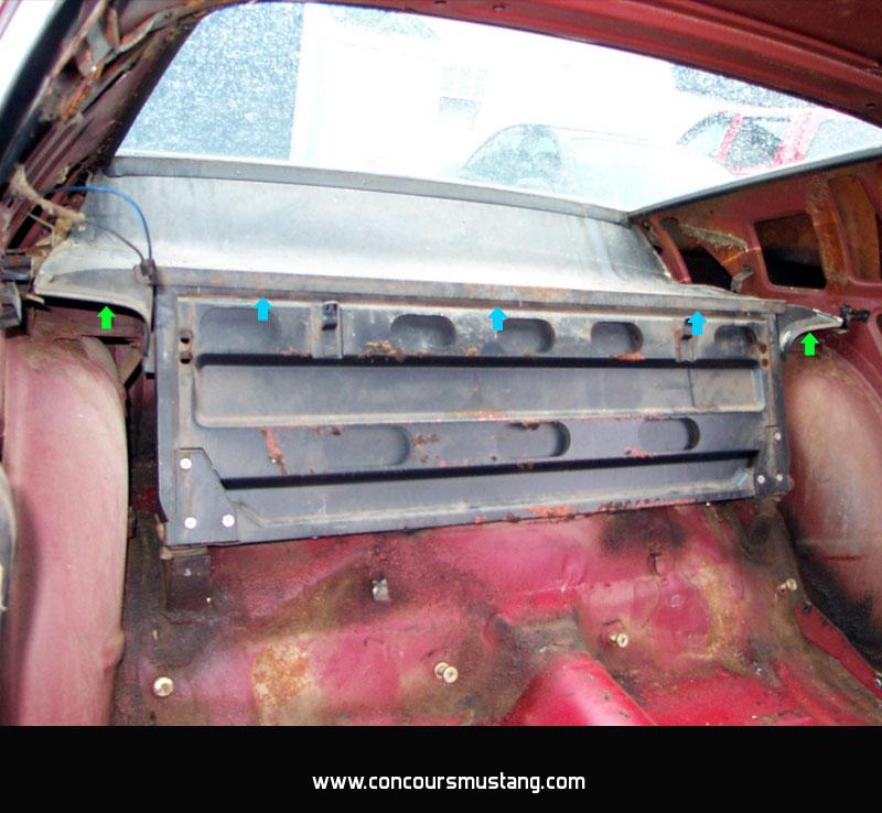

Was asked about this items a couple fo days ago so figured I should posted them on the site to help members and you lurkers in the future
Focus is on the upper rear seat trim panel highlighted by the blue arrows and the end caps highlighted by the green arrows.

Unfortunately that drawing relates to 67-68 only and Ford incorrectly indicated that the drawing is related to 67-70 :(
Only a couple of brackets are similar or same. 69-70 has a larger package tray that sits level with the top of the rear seat cushion and no corner fiberglass/ plastic rear side panels or trap door cover
