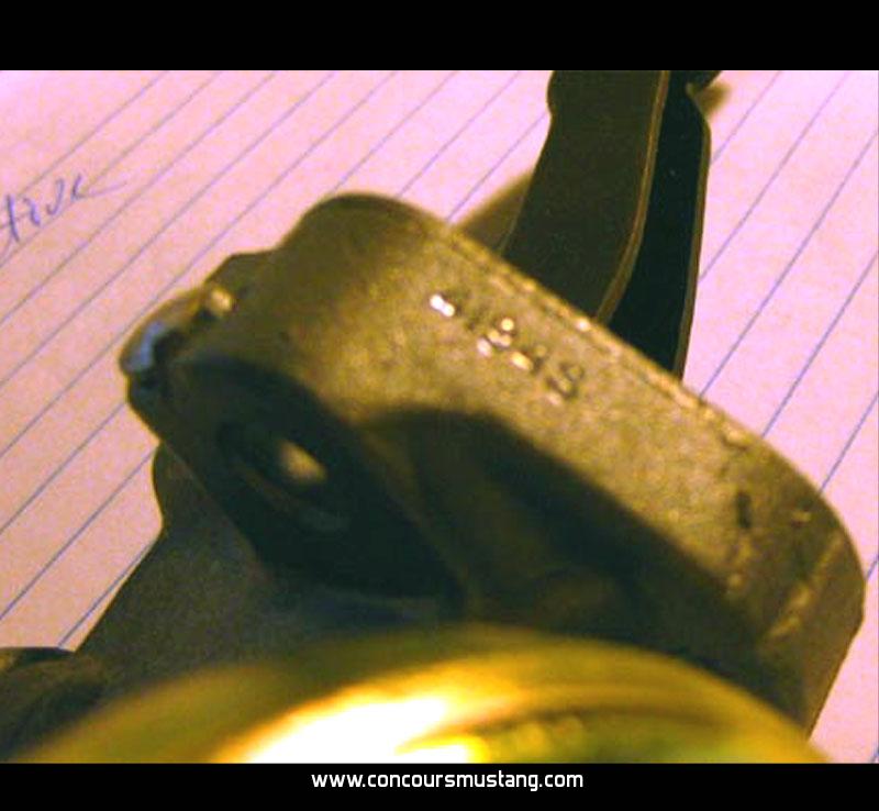

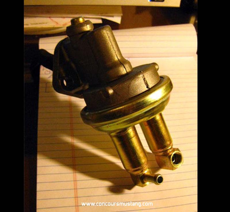

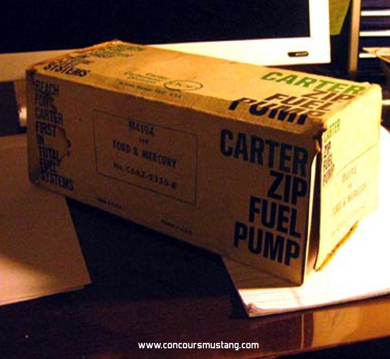

Here are a few pictures of the pump mentioned below. These were used on 67- 69 I believe S code Mustang, Cougars, Torino's Fairlanes and others
Part number - C6AZ-9350-B
Carter part number and stamped on mounting flange side  - 4194-S
In a Carter box rather than Autolite
