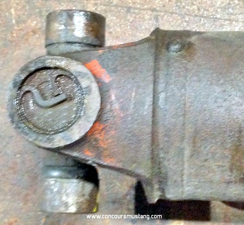

Here is a drive shaft from a 68 428 CJ that I am working on.

I do not know what the color codes mean other than to tell the line worker which one he needed to use. I am very carful to look for the colors as I start cleaning the metal. I document the location and colors then I use Testers model paint that I mix to get close to the color I found. On the ends  I use Rust Oleum Redwood semi gloss. Have you search for the build sheet? That is your best hope of finding the correct colors.

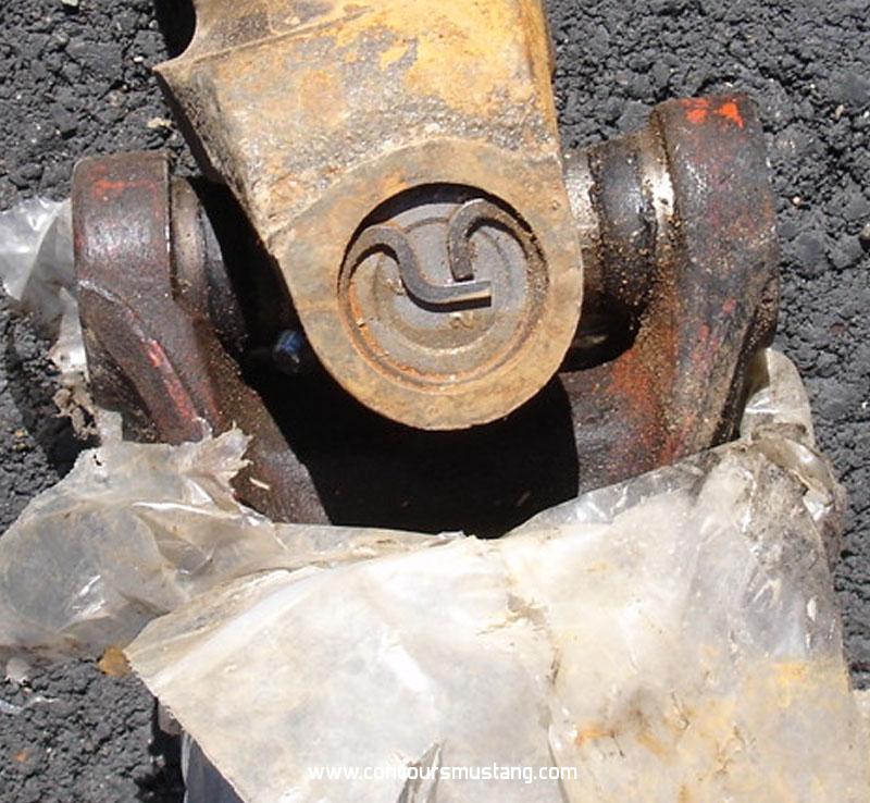

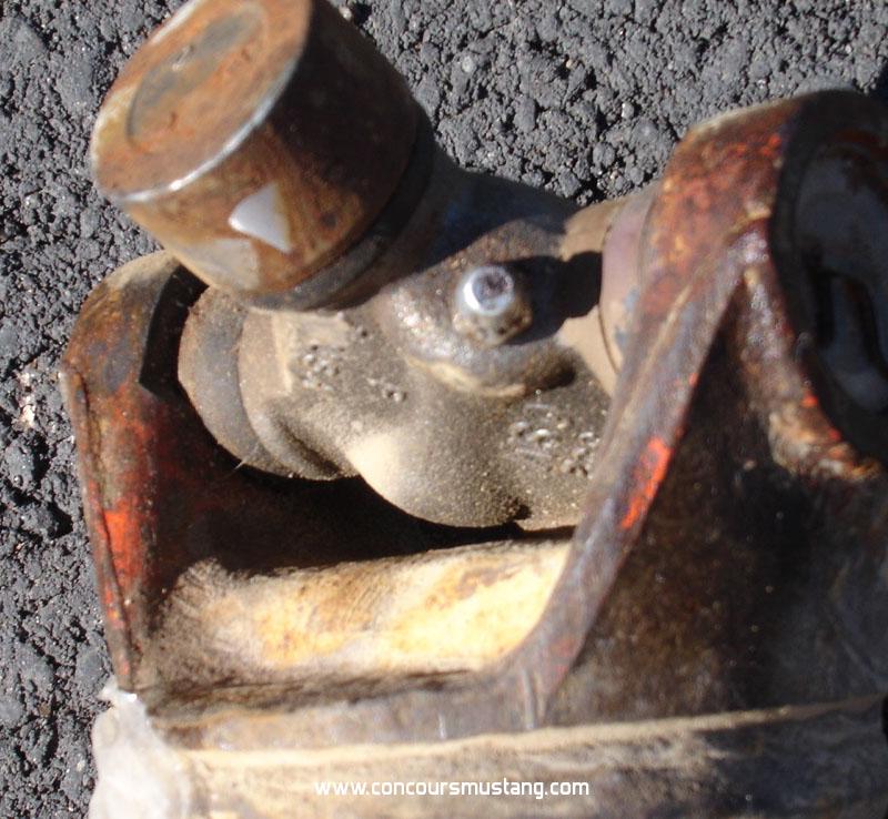

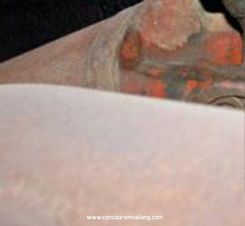

Here is a number of examples of the end yoke colors I've got pictures of for 68 big blocks. These, in person, were a strong true orange which would match very closely Testor and many other oranges straight out of a jar or bottle. Will take a number of bottles if you use Testor
This one shared earlier in another thread
Thanks Jeff. I did take note and photos of my drive shaft before I stripped it and also the yoke and U joints. I did notice the orange there as well as some blue. FYI i did find my build sheet wrapped around the wiring harness under the dash, but it is almost all disintegrated or was eaten by mice
