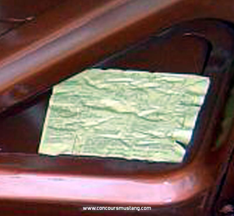

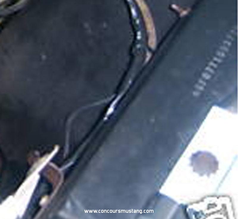

Looked through my pictures and came up with one example that may help.
Difficult to read the VIN but it appears that it might be in your cars general time period and had the C6 version of the sticker attached to the trunk lid
Do have another from 6T1488xx but its just about impossible to make out but may also be a C6. Depends on if the details are lines, shadows or wrinkles

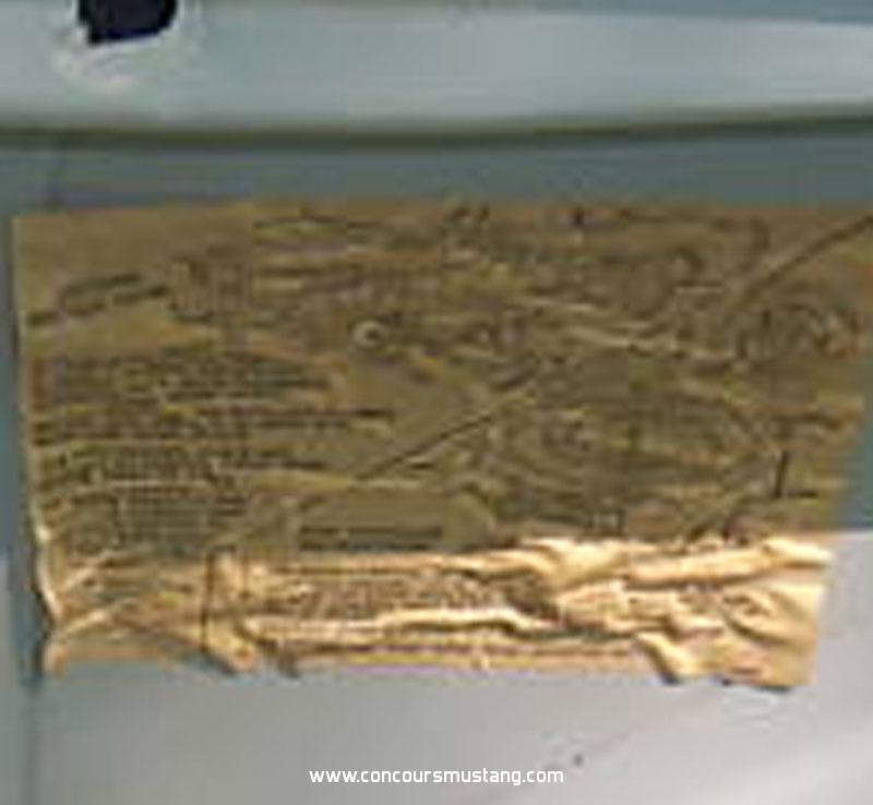

Good news & bad news. It’s a C6 but the rest of the part # is different from repos shown. Also note the word END above FILLER which is on the left in the repop versions.
