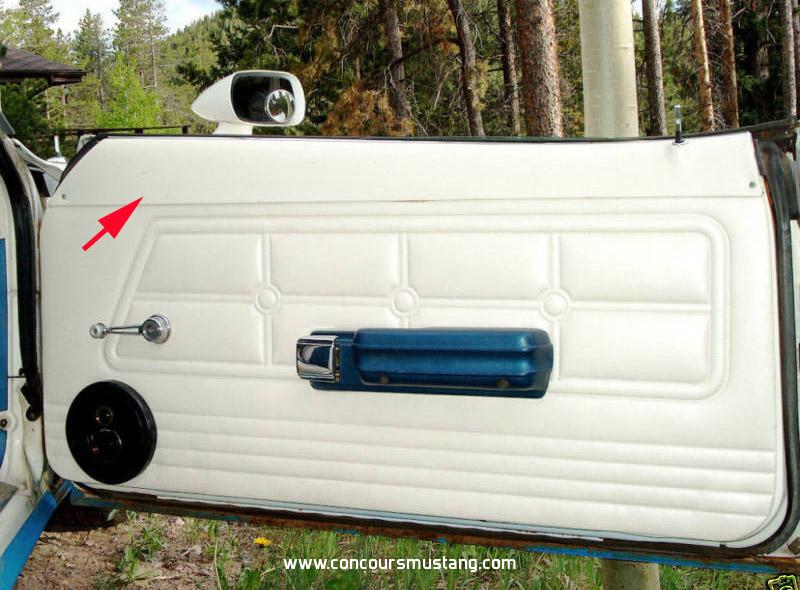

For '72 was the door grain a stamped pattern in the metal or applied as a texture prior to paint?
  • Posts: 9526
Re: Painting Door Grain
« Reply #12 on: September 15, 2024, 12:16:05 PM »
The door grain is stamped into the metal.
« Reply #13 on: September 15, 2024, 05:55:59 PM »
Guess you have standard interior and your askign about the thin door trim panel on the top edge of the interior of the door.
As Bob wrote its stamped in the steel so to refinish it you'll need to strip (not sand) all of the piant off and repaintit without putting on too much paint and filling the grain. Real easy job
For others watching no that isn't a factory speaker or grill just a handy generic 72 door panel pictures I found quickly
