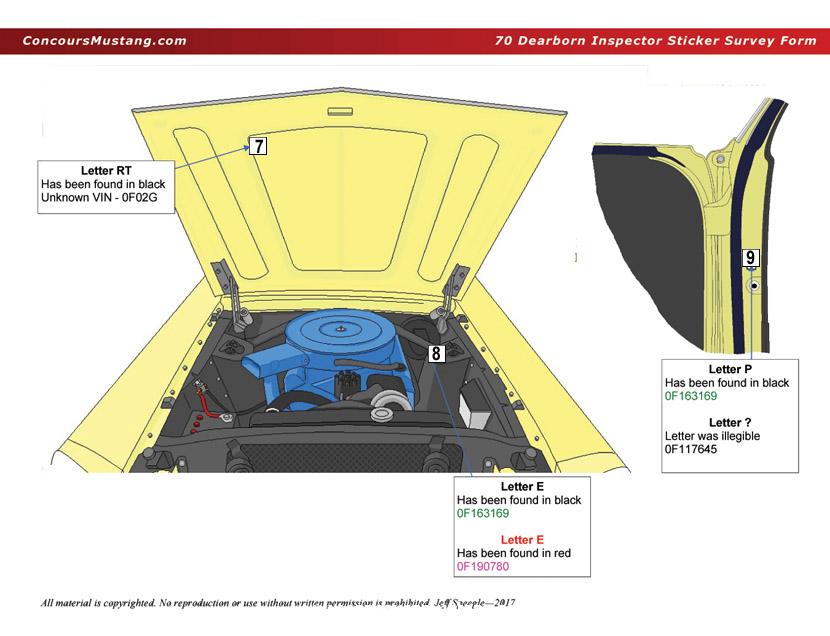

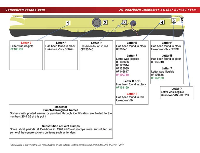

Lucky me - I didn't have to start from square 1 this time - though I had looked into this before for one of builders/shops, so it helps out here. Appears that the document was then altered with the intent to add it as an article to the Library just had not reached the point were it was ready to place there yet. The following graphics only represent the findings I found and should not be seen to suggest that all locations and stickers were used/applied on all cars built at Dearborn during 1970 production, though some may have been.  It is part of an ongoing effort to collect and better understand the practices. Hope it helps others.
For others viewing this that own cars with stickers that are still legible please add to my list of findings with the location number, the letter (letter and color of letter) and your vin, shortened vin or the build date of your example.
Had to convert these back from a pdf format Hope their easy to read our will have to redo them
Did adjust the title to better reflect the direction and focus of the thread ;)
