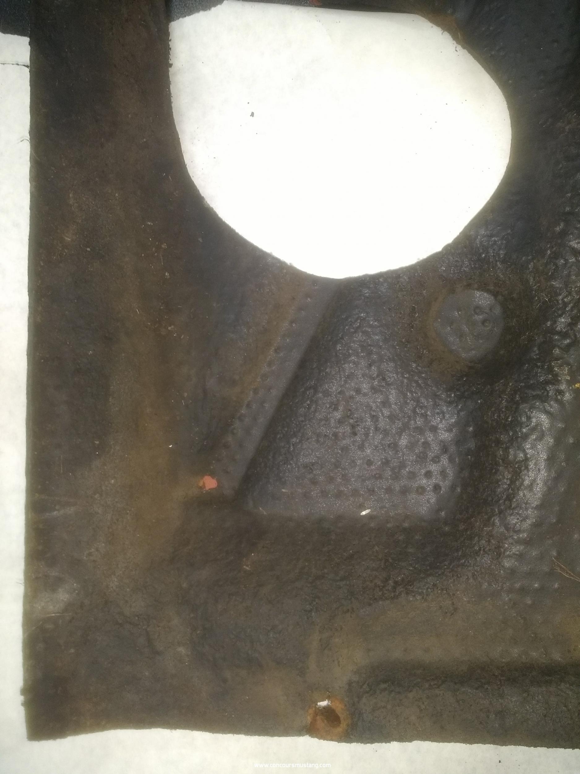

« Reply #14 on: February 11, 2018, 03:35:50 PM »
I finally got the firewall pad out of my 67 SJ parts car.
However, this pad has much less detail in the area that I think judges look (under the heater).
One might think that perhaps someone messed with it, but this thing also shows signs of imperfect molding elsewhere.
The bottom has very few dots and some areas show a spider web effect where much less product was used. See the area straight up (3" actual) from the firewall pin hole.
At this point I'm tempted to create a large mold (cut the firewall out of the parts car to start) and repop this thing.
