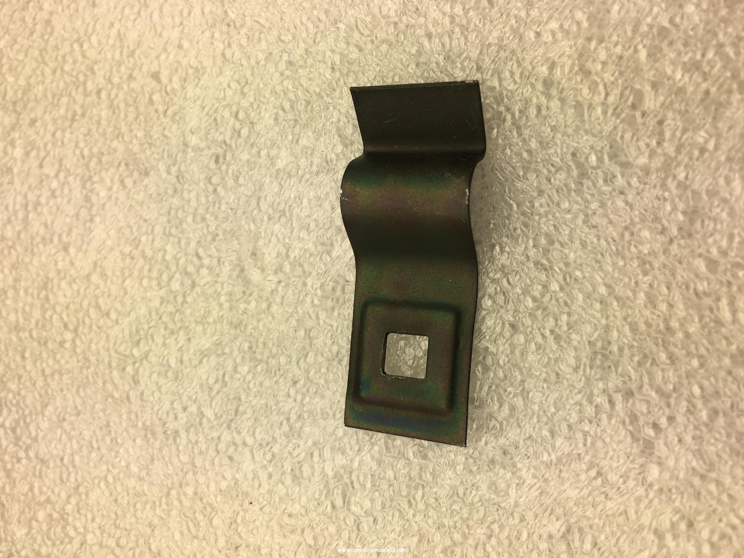

This is the best image I have on my phone.

That color looks similar to the bucket seat spacer/carpet protector found on some 66's
I have some original 65-early 67 seat track plates with good plating still and the black chromate is what it appears to be. It match's perfectly.
