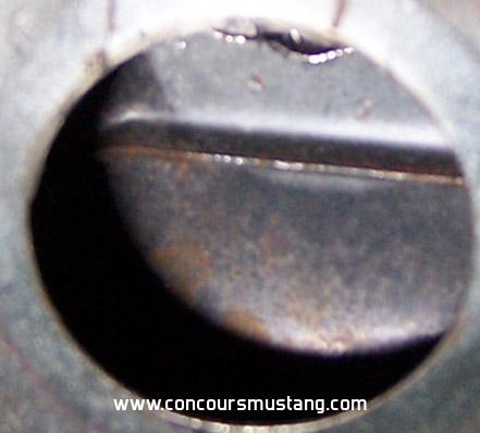

For the period production you identified and looking at the few examples I have from that period I would go with a batch color from the firewall rearward and red oxide from approx the firewall forward
Here is an example of a pretty dark gray without either a blue or green tint often seen IMHO from a car possibly built within days of your car at Dearborn.
The area to focus on it directly below the bracket where it is not reflecting any light from the flashlight and has been protected from the elements for all these years.  Rest of the exposed floor on this example did not generate any good exposed areas leaving us with just the little peek

Here is a pic of one of the underside of one of the seat pedestals. You can clearly see the slop gray overspray that came though the seat bolt access holes. My Mach is Dearborn built in March, 1970.
