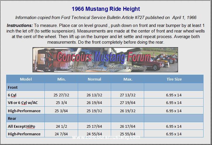

A- What was the original ride height of my car?
From the 66 TSB's so it likely applies to 65
More will be added as time passes - Thanks
