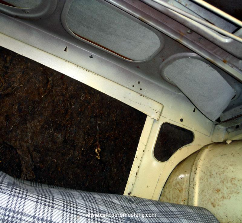

If I understand what your describing you would need to fill the screw holes (hope they didn't cut the package tray to install larger speakers  ::) replace the package with a new one and if they are still there reinstall the factory retainers for the package tray.  If they hacked the metal panel under the package tray that is going to be a much larger task. In the example below the owner left out a few retaining brackets. I'll find a picture of those
Picture is from a 65 coupe using the "cardboard" style divider

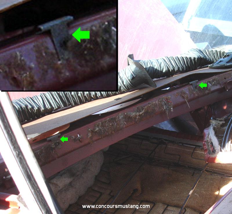

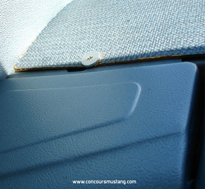

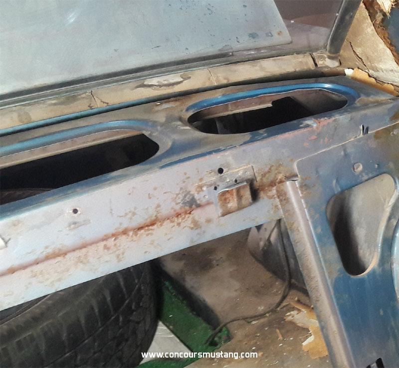

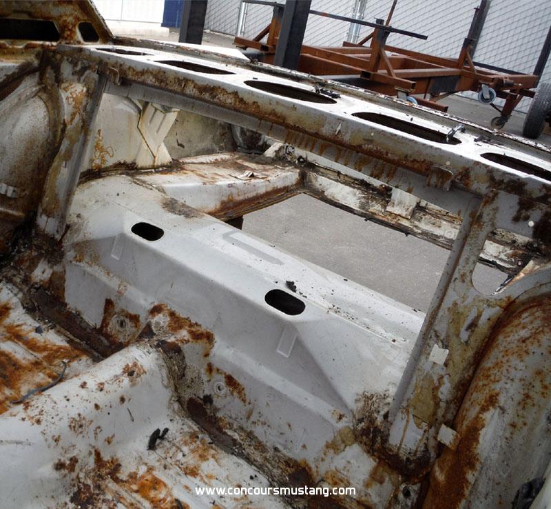

Some pictures
Here is a picture of one of the outer two (one each side) screws and location. From a thread in the unrestored picture section
Late 66 San Jose coupe
A shot of the inner front package tray retainers from 6R1590xx
« Last Edit: April 04, 2019, 04:44:09 PM by J_Speegle »

Don't recall ever finding nor could I find any pictures in my collection of cars with the remains or signs of any prior adhesive being applied to the painted metal surface of the package tray.  Other adhesives we find usually leave something behind such as other interior applications or int he trunk
Think this may be a detail in the manual that was not done at the plant, at least San Jose or only for a very short production period.
Do see the very thin insulator between the Masonite and the metal section. Really thin and an off white at least on late cars on the visible side. This example is 6R204xxx
