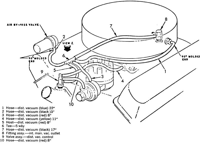

Believe allot of owners use the multi port plastic vacuum t available at many parts stores. Its normally with all the little stuff in the little packages like generic hardware, door handles and the like. Seen them in a white or opaque plastic.
Finding a picture of the routing is difficult and there seems to be a couple of versions but the item you're lookign for doesn't seem to be affected by the differences.
Here is a Ford diagram of the system without the ram air but the hose for the side of this ari cleaner is simply moved to the shaker flapper in some diagrams such as shown on the Dead-Nuts- On web site - link below
https://www.deadnutson.com/boss-302-vacuum-hose-kit/
