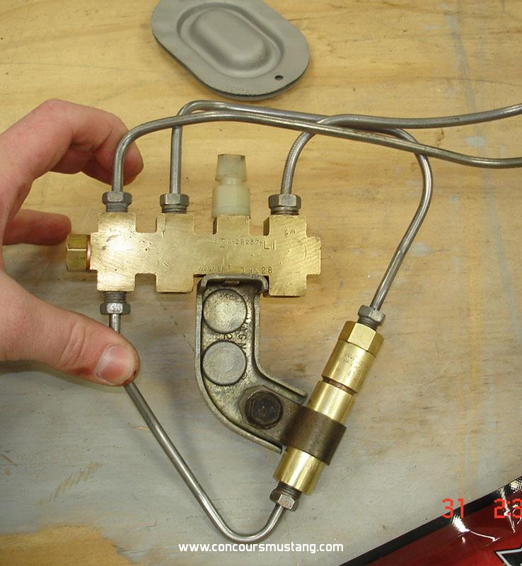

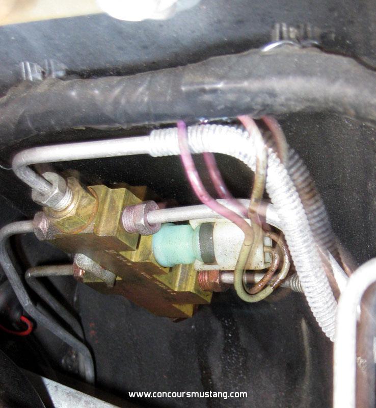

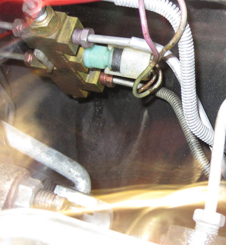

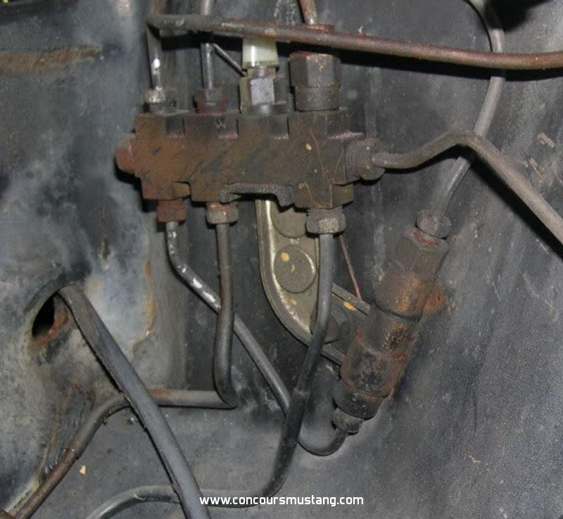

Re: 69-70 front disk brake proportioning valve question
« Reply #5 on: May 12, 2019, 02:33:32 AM »
Some examples From what was handy
69's
70
« Last Edit: May 12, 2019, 05:18:31 AM by J_Speegle »
« Reply #7 on: May 12, 2019, 05:22:37 AM »
Jeff,
Thanks.  I studied the pics and for the life of me cannot see the difference.
My mistake for doing this so late. Originally showed the first picture twice first as a 69 and then as a 70 and I'm certain this confused things for you. Fixed it and you can see that the blocks are mounted differently (orientation) so the brackets are different and the 69 has a separate proporsioning value below and to the right where the 70 does not. Connections for the brake lines for 69 have three on the top and one on the bottom as well as the one on the end. While 70 has two on each side with the one at the end
Sorry for causing any confusion
