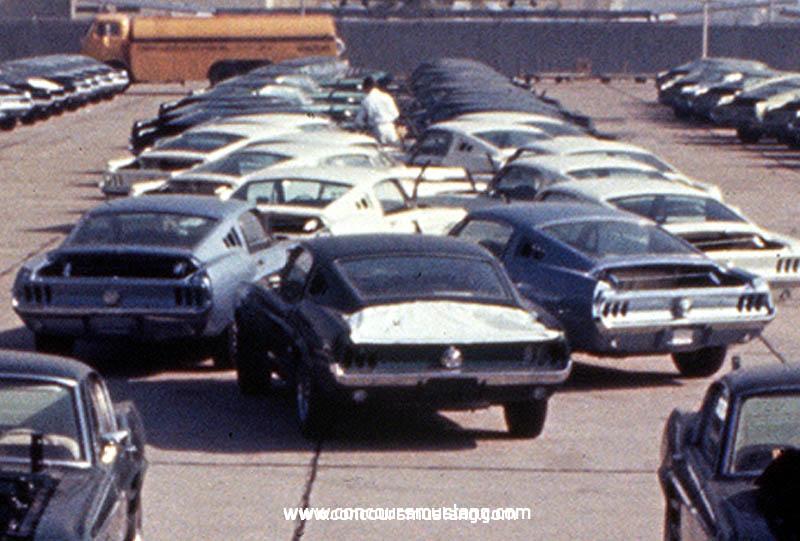

I thought I had the painting sequence down but the hinge paint sequence was still confusing. Then I actually looked at my laptop background of a bunch of 67 Mustangs in the Shelby lot waiting to be converted. It's shown here.
In that pic there are a number of cars without the rear plastic cover. And then I noticed that all of the uncovered cars had full paint coverage on the part of the hinge that contacts the trunk lid. (Shelbys were painted at the SJ plant without a trunk lid or any rear end caps)

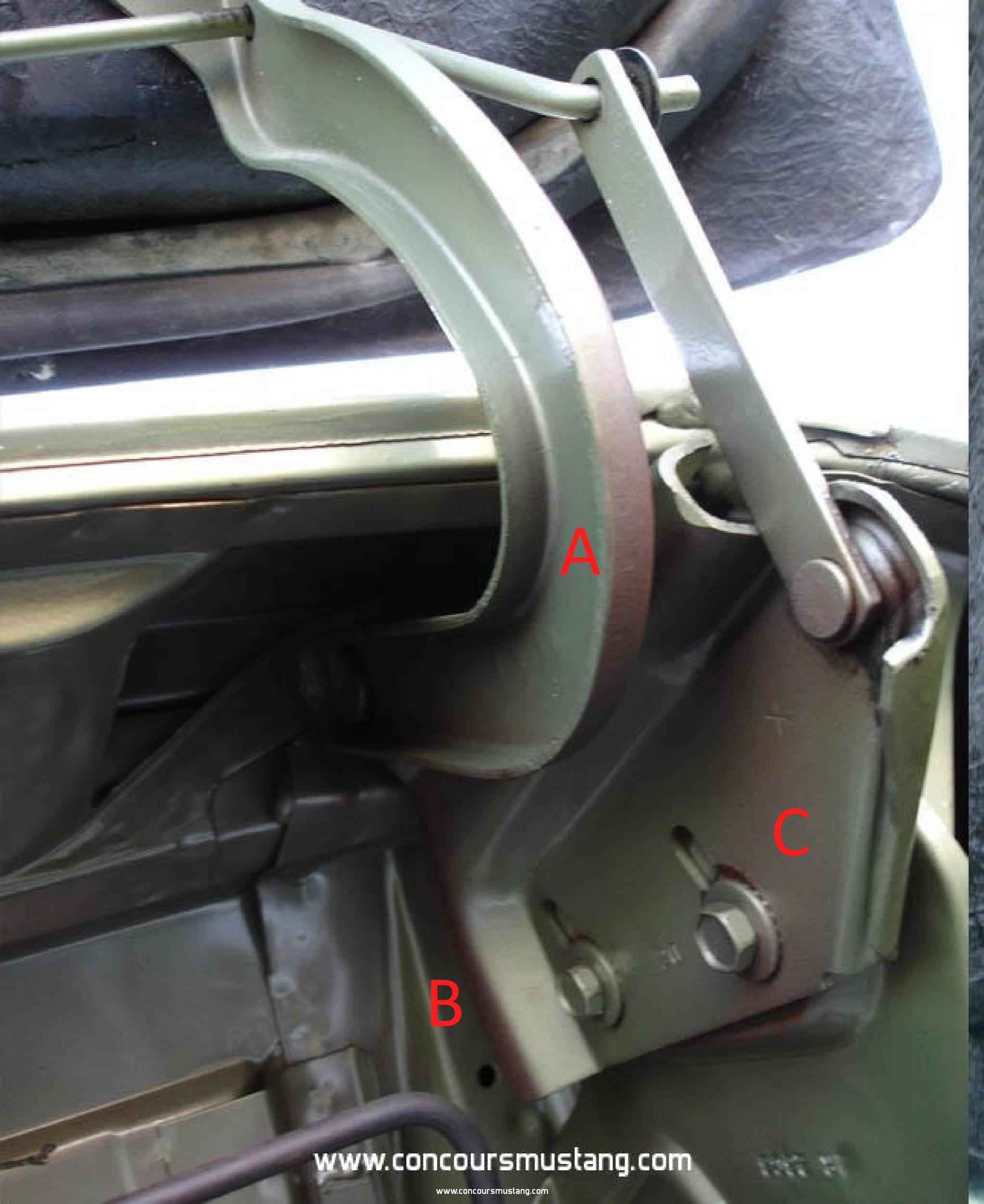

I was always wondering why the underside of the hinge had little paint in Shelbys

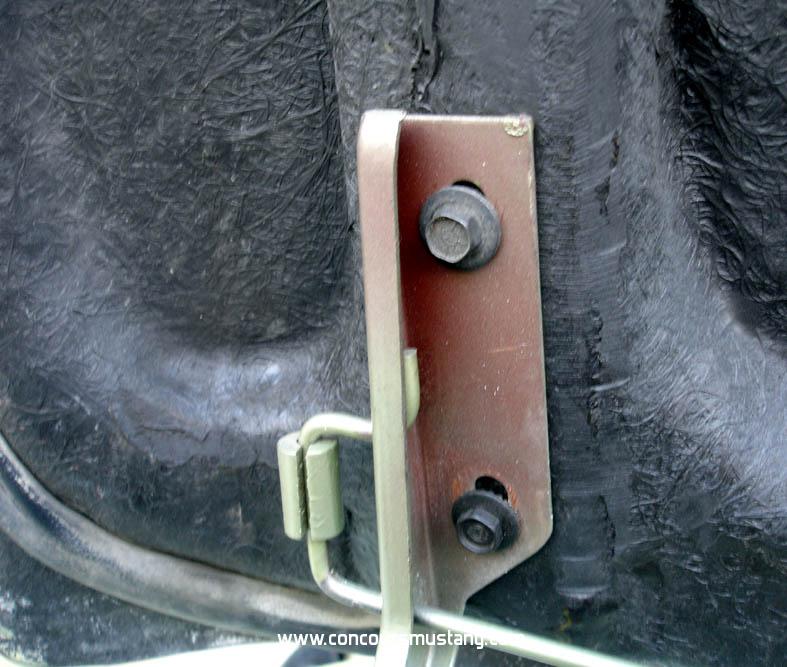

I also wondered how the particular shadows got there in this picture:
It's been assumed that Shelbys were painted with the hinges up, just like Mustangs.
What I surmise from these pictures is:
* There is full paint coverage on the top of the hinges
* There is almost no coverage on the underside of the hinge
* If the hinge was up there would be paint on the red oxide portion at label A
* If the hinge was down it would account for the lack of paint at label B
* If the hinge was down it would account for the lack of paint at label C
* If the hinges were sprung and up the lack of a decklid forces the passenger hinge into contact with the trunk lip, leaving a telltale lack of paint
I surmise from the paint details that Shelbys were painted with the trunk hinges down, not up. Only down accounts for all of these details.

Good catch. I agree with you.
Don't believe I agree fully. Some may have been but IMHO the statement is to broad when you look at one example and try and apply it to all 67 Shelbys.
How were the spring and retaining donut painted so well if painted down?  And how was each hinge held downward since the spring was installed?
With those question we may be focusing on one example where they may have painted it down or partially retracted but believe we need to look at others to get a better look at production practices
It is interesting that during the period of when the storage area picture was taken the hinges appear to be retracted on those cars. Wonder how they were held down with the trunk spring in place
Will collect up other examples and lets see where it takes us

The lot pictures show that the hinges had to be held down in some fashion or another down given the plastic covering the trunk area of Shelby units for shipment. They may have taken the spring bar loose at the fashioner and allowed the bar to rest in the trunk however that would most likely had been after painting given the paint angles covered.
Agreed they are in the down position allowing for the sealing of the trunk, in transit. Looking at the Goodyear picture its hard to see colored cars but the lighter and white cars the details stand out and it appears that the trunk spring is fully in place IMHO but hinges are still retracted.  If they had disengaged the spring on one side (the drivers side) this would have meant the extra rubber donut would be removed and we would find scratches in the paint on that end of the spring from removal and re-installation.  It would also mean that the donut would have had to be transported with the car since, located and reinstalled also.
Two areas of the one Good year picture enlarged below showing full view of a blue and white example. To me both appear to have the spring fully engaged though both hinges are in the down position. Dows not appear that the far passenger end of the spring is disengaged and that would show up in original examples with marks from removing and re-installation of the end clip and what ever damage would happen to the paint on both.
Will look to see if we can find, on those cars where the outer end of the hinges are fully painted, provides a clue maybe scratches or marks from being "tied down"
Considered all fo this a few times just never took the time to go through the process and discuss the possibilities.  Guess the time is now ;)
