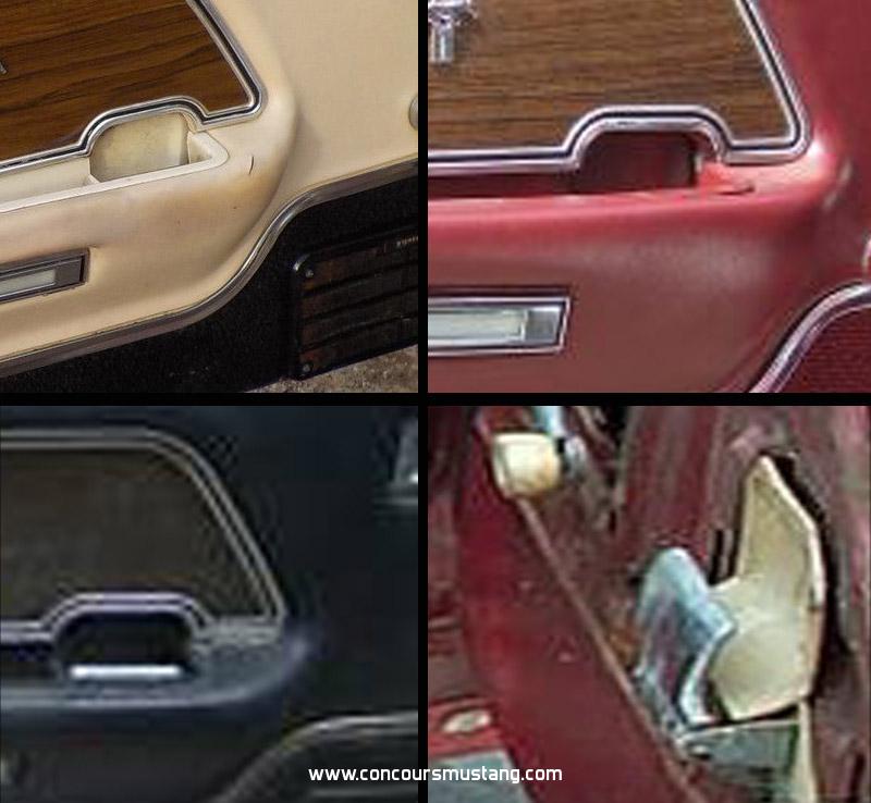

my door panels are missing the part behind the inside door handle....pictures anyone?

Metal"L" bracket on door shell ,metal door cup or rubber cover over screws?

Bob,
looking at all of the mentioned...
is the metal door cup behind the door handle painted to match door panel color is it chrome?...........

The metal door cup is painted to match door panel , black,white etc. same with the textured rubber insert used to cover the screw heads inside of the cup.

The standard panel cups have a trim of plastic "chrome" as Bob explained the Grande/Mach door panel cups are molded in the color to match (monotone)  the door panels
Hope the picture helps illustrate

excellent fellas.....
