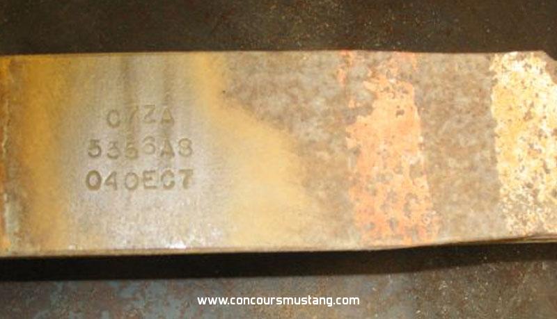

As mentioned earlier service replacements/later NOS will often be stamped differently than factory - Example below
Offline bullitt68
  • Posts: 2221
Re: 1968 San Jose GT 390 Fastback NOS Leaf Springs vs Repro
« Reply #26 on: October 30, 2019, 06:08:19 PM »
Thanks Jeff just confirming those are factory replacement and not factory installed original stamoing

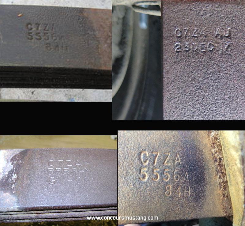

« Reply #27 on: October 30, 2019, 07:06:25 PM »
Thanks Jeff just confirming those are factory replacement and not factory installed original stamping
Yes
Here are some examples of stampings from assembly line rear springs. Couple of them were lose springs the lower left is one identified as coming from a 68 San Jose Mustang. One supplier (the upper tight identified as coming from a 68 NJ car) stamped them cross wise to the length of the leaf)

Yes
Great stamps. Thanks Jeff. Now I know what I am looking for. The hunt continues

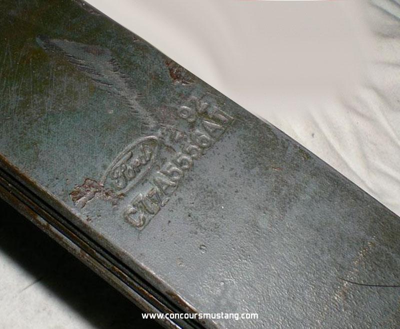

« Reply #29 on: October 30, 2019, 07:38:45 PM »
This should be one of the possible springs you'll be looking for - C7ZA-5556-AS
Often what was installed but it depends on what options your car came with in addition to being a very late GT 390 4 speed fastback. Things like AC and PS often are part of the differences. Picture is also from a San Jose built (and supplier) example
