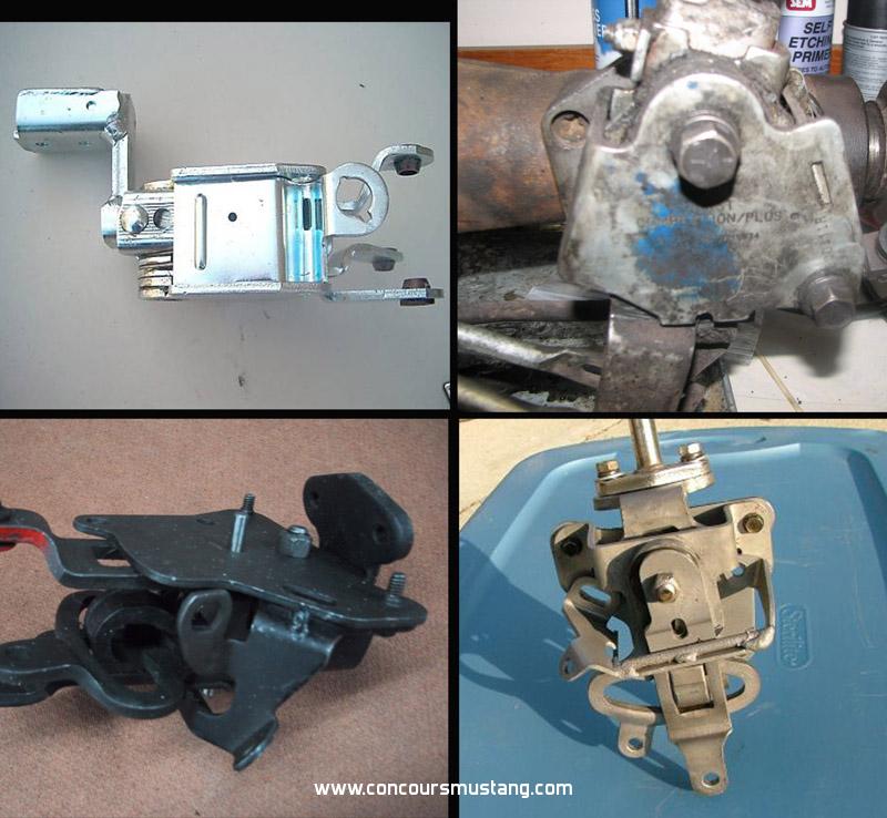

It is my understanding that the Hurst shifters factory installed on Mustangs use the Ford arms to the transmission, a Ford housing and that was mated up to a Hurst arm. It was mostly for show.
Not on the ones I have pictures of or have owned. Shifter is Hurst and I don't know any easy way to attach a Hurst arm to a Ford box.
In 70 the rods as well as the lock out do carry ford numbers on the arms
Hurst upper and Ford lower - Notice how different the handle attachment configuration/pad is
Believe we've responded to the original question and are now getting a bit off thread and onto other years.

What I described as to the Hurst upper shifter arm and Ford lower housing setup was what was said to have been used back in the '70...............
Just to clarify my post. The upper two pictures are a 70 Mustang Hurst shifter the lower two are the 69 (specifically) and similar to earlier Ford version, shifter.

Hi Jim, Just for some clarification ….. The Hurst shifter supplied on all 70-73 4 speed cars used a shifter body and handle supplied by Hurst, and rods and tabs supplied by Ford. That said, the shifter itself was a Competition Plus that was modified to meet Ford engineering requirements. They have larger holes in the levers for the press in shifter bushings, a slide in handle isolated in rubber for vibration, a tab for a reverse light switch, and no stop bolts. The shift lever is also a custom ford design (shorter than the aftermarket mustang lever) All the mods were made for either vibration isolation or manufacturing cost savings. (the reverse light switch adjusted itself the first time you put it in reverse, and eliminating the stop bolts meant they didn't have to adjust them. The Ford designed rods were also alot faster to adjust than the aftermarket Hurst stuff.
All that said, even the Factory Hurst shifter is WAYYY better that the Ford manufactured one, especially the 69 version, and if you really want, you can drill and tap to add the stop bolts ….
