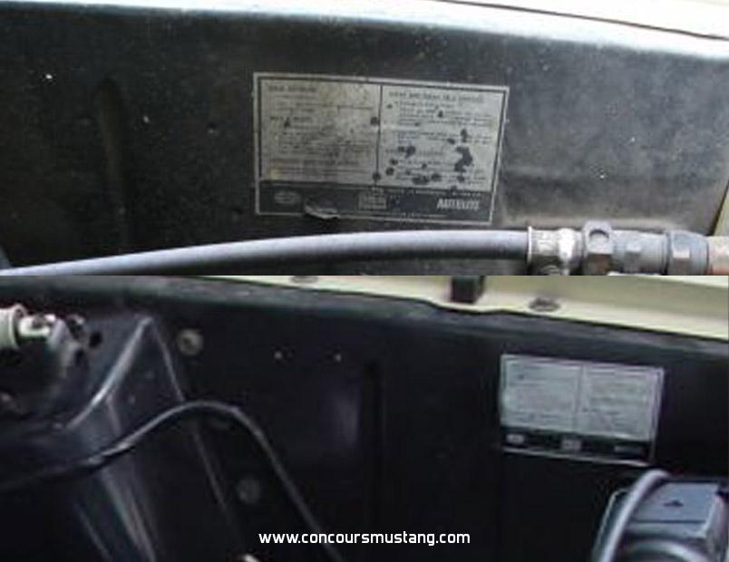

ENGINE COMPARTMENT

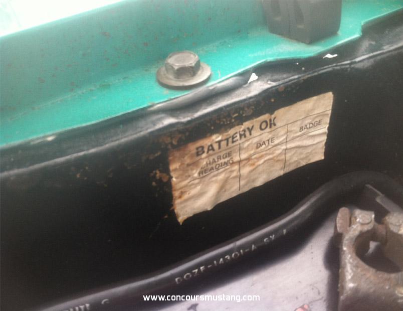

Battery inspection sticker. Originally paper based with no clear cover/top layer so they didn't last long. Your looking for the black printed version with the sharp corners and intersecting lines. Don't know of anyone supplying a complete good reproduction filled out correctly for a NJ 70 car.  Example though the information is not legible
Service specifications- What appears to be a form of Mylar over a paper based sticker. Two examples of their general location for cars during your production period. Later in the year the location appears to change
Air Cleaner Cubic Inch - Ignore the other decal. Just a Calif post production smog sticker. Paper with clear top layer over paper sticker

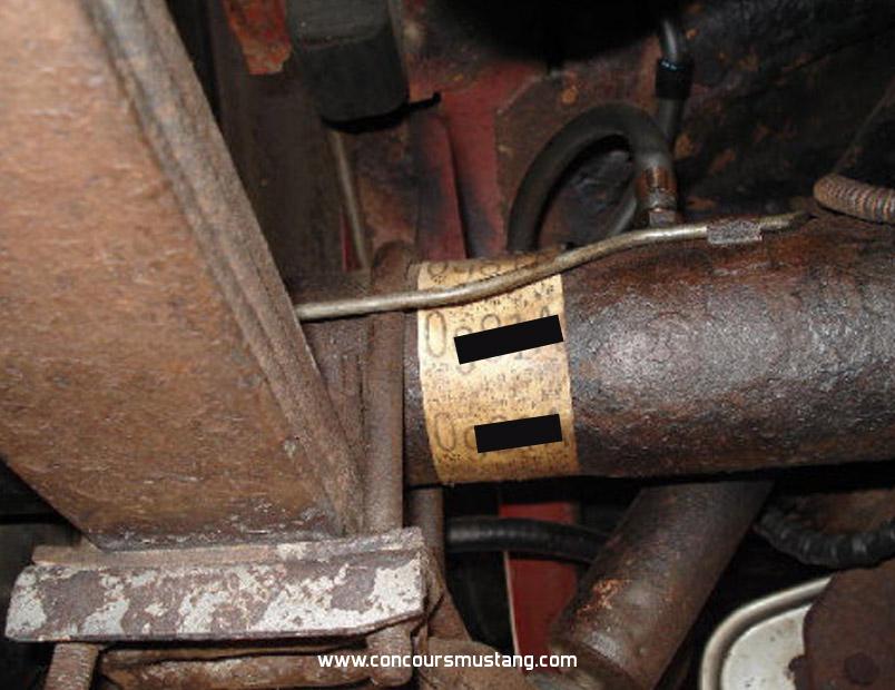

Air Filter Service Replacement - Paper with clear top layer over paper sticker. Original and good reproduction will include the part number for the filter on the bottom line of the decal

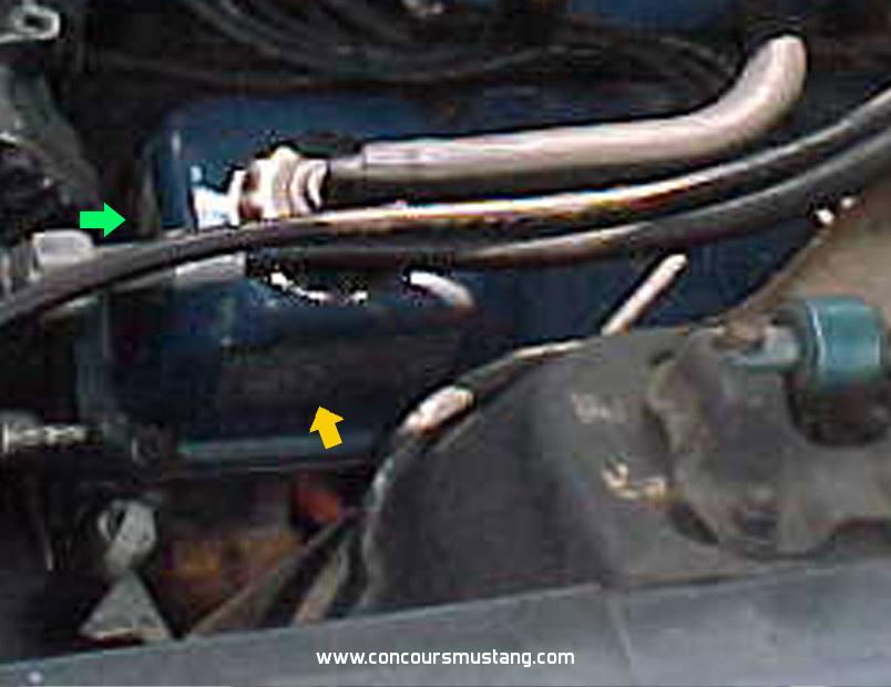

Engine ID & Timing/Emission - Engine ID (green arrow) Timing/Emission (gold arrow) Both paper with clear top layer over paper sticker. Engine id stickers would have been on a roll and torn at the ends similar to the torn/cut edges used on a coarse toothed packaging tape dispenser

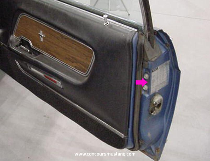

INTERIOR
Tire Pressure - What appears to be a form of Mylar over a paper based sticker.  Not sure what version (haven't studied these closely ) of the sticker would be correct for your application.

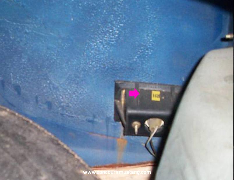

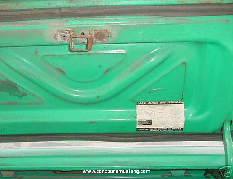

Jack Instructions - Paper with no clear top layer applied to the lower passenger corner of the trunk lid typically on sportroof/Mach I  applications. On cars equipped with space saver tires an additional decal/sticker would have been applied typically to the driver side of this decal
Rear Side Marker Light Retainers - One for each side LH and RH

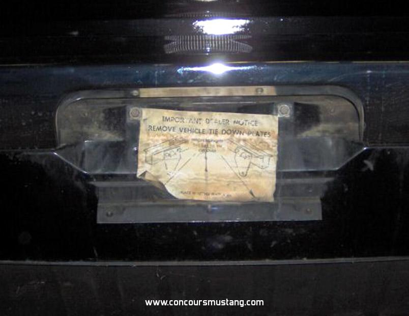

EXTERIOR
Shipping Tie Down - Plain paper with no clear coat/layer

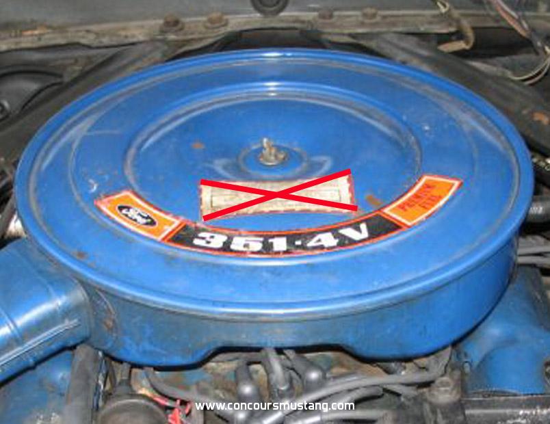

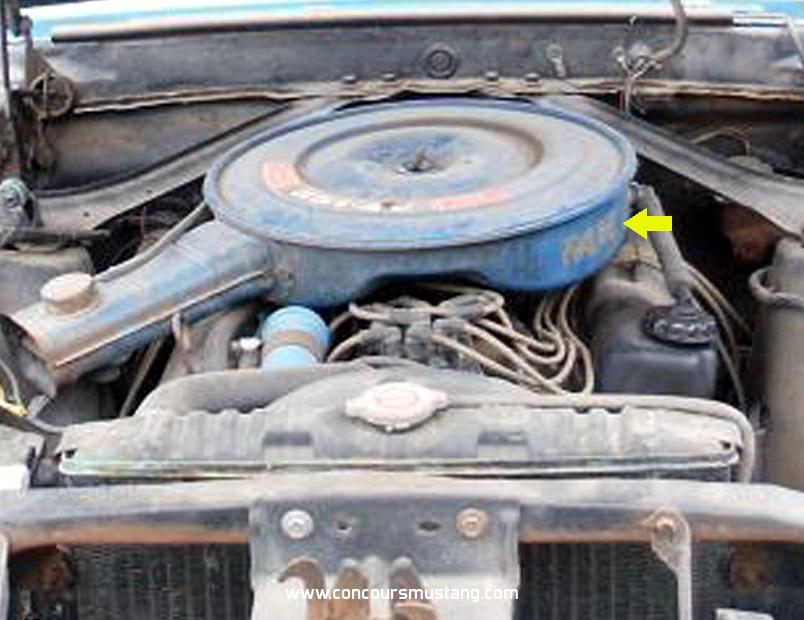

Hi Jeff, I'm just getting around to installing some of these decals and just had a quick question. In the two-part picture for the service specifications, where is the approximate location shown in the top part of the picture? It's hard to tell because I only see part of the one hose as a reference. Thanks!

The Xed out rectangular decal on the air cleaner - two of my DB cars have these! Wonder if dealers applied them like the Caution Fan decal.
Carl
70 and 71 Dearborn mach Is
