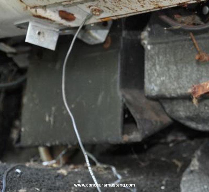

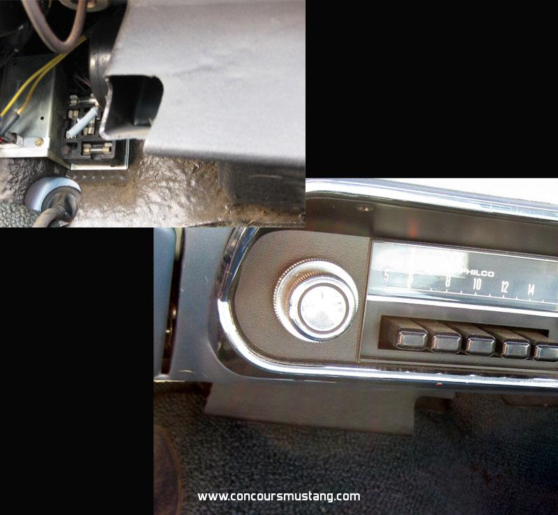

« Reply #1 on: January 15, 2020, 08:39:36 PM »
Larger - one on right appears its likely from a different application (Modified - Marty's post below does point out the picture/example below is from a non-console car)
Picture of a 68 AC application below - Source 8R1267xx Nice original car shown in the Unrestored picture section  (Jan? 68 San Jose C code bench seat coupe....) one or two additional angles there

« Reply #2 on: January 15, 2020, 08:48:09 PM »
I have always thought one was for a AC car with console and the other was for a AC car with out console.
Re: Help ID air conditioning system plenum
« Reply #3 on: January 15, 2020, 10:07:53 PM »
Should have kept looking. Had to go back to my 67 pictures to find a clear (with the console out of the way) picture of a  67 AC with console car to find an example. As always - no one is smarter than all of us together :) Corrected/altered my post above
