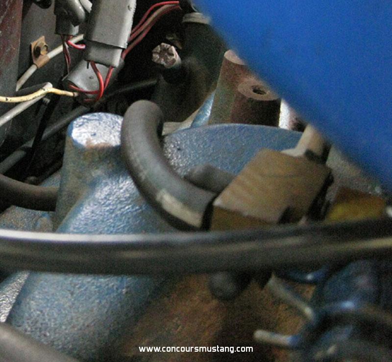

I suppose you already saw this thread and have read the article Marcus did.
It has at least one picture related to your requests
As the picture shows not all of the system was painted engine color but that is only a couple of pieces in a much larger system but focusing on the outer curved hose,  yes you can find blue paint out to the end of the hose  including sometimes even the PCV block  (as Bob mentions above) where it attaches to the PCV  or others fade away back at the first formed bend in that hose as well as in between these two points (Wording as been changed to clarified better - too many not's and nor's in the first version :)
Picture from the unrestored picture thread showing the remains of blue paint way out towards the end on this example
The rear attachment point from another example in the Unrestored picture thread
