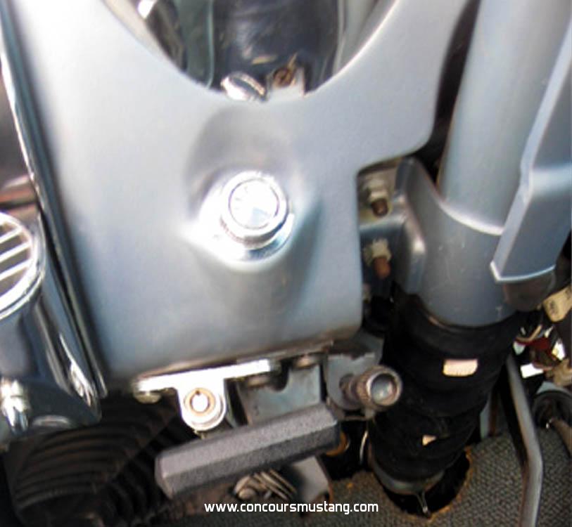

Just curious regarding these steering column parts. The parts that are actual on the column itself look like a much blacker paint as opposed to the charcoal metallic on the other hardware parts. I just want to confirm if the column received the charcoal metallic or did it get a different color of paint. Or was that just due to the fact that the steering column parts are pot/cast metal opposed to a raw metal finish. Also not sure about the firewall bracket as it does look like a semi satin black
My recall of 68 San Jose pieces was that the clamp (bottom one) were black while the parts that make up the steering column itself with Charcoal. Lets see what others have found
The lower firewall bracket/clamp I seem to remember as being dipped or at least some with heavy runs - will check my pictures
« Last Edit: March 04, 2020, 07:59:42 PM by J_Speegle »

My recall of 68 San Jose pieces was that the clamp (top and bottom ones) were black while the parts that make up the steering column itself with Charcoal. Lets see what others have found
Interesting. I was assuming that those parts on my car were original, but can't say 100%. I am close to being ready to paint those parts and just want to make sure I am painting them all the correct color. I also assumed that not only is the paint original, but also the correct color as well. Better to be safe than sorry. Most other cars that I have seen seem to have had the darker almost black look compared to the very obvious charcoal metallic parts on my car

« Reply #12 on: March 04, 2020, 08:00:53 PM »
Corrected my earlier response since it makes sense that the upper clamp matched the steering column. I was reminded of this once I look through the pictures and saw the cars with other interior colors  and how they were painted/color applied

« Reply #13 on: March 04, 2020, 08:22:15 PM »
Great reference thanks Jeff. That shows me the parts that got black and the parts that get the charcoal metallic

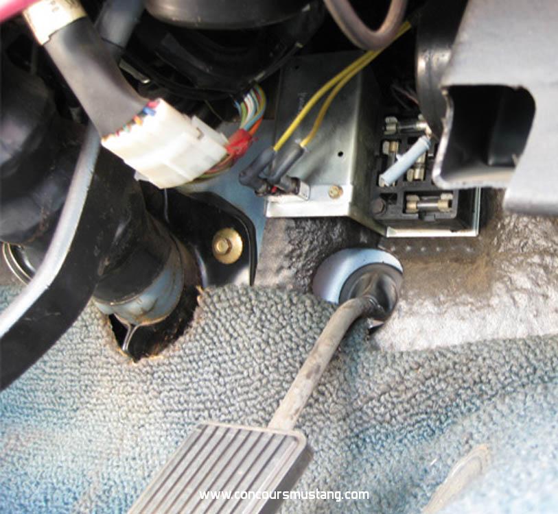

« Reply #14 on: March 04, 2020, 08:28:45 PM »
On another note look at the coverage of interior color on the floor behind the carpet. Very interesting. I did not realize that there was so much over spray on the floor area under the dash. My car seems to be a bit of an anomaly as it did not have much overspray inside the interior for the most part and minimal sound deadener and Seam sealer. Perhaps my car was built on a Friday and they just wanted to get it done quick!
