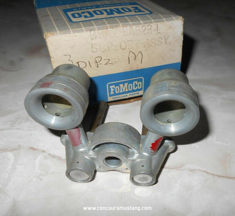

Re: Hunting A Ford 4100-A Carburetor Part Color Code
« Reply #3 on: August 31, 2021, 04:25:15 PM »
Don't know why I didn't look earlier but don't seem to have much in the way of the early-early 4100 pictures as far as paint markings
Did have this showing the 50's part number and the same red marking that the one in your initial post showed. Did not take the time to look up the original application

Jeff,
In Bob Mannel's online book it shows the later service carburetors using different "supports" than the assembly line models.
1956-1967 Ford used all kinds of color code dip dyes and or paint daubs for quick visual identification of "supports". I can imagine assembly workers using color codes and not full engineering numbers to pull parts from bins. Whole assemblies could be dipped in a colorant or daubed with paints or both. One daub or two, one color or two, and etcetera.  Same was true of automatic choke assemblies. I have seen plain, deep red, deep blue, and bronze (called red or orange in Ford listings). Ditto economizer (a.k.a. power) valves dipped in colorant dyes for quick identification.  Some Keps type nuts were dipped in dilute colorant dyes, my guess size and thread identification. The one in Ford carburetors almost always corroded appear to have been bright zinc plated and then dipped in a dye to give them a faint yellowish color. The color comes off real easily.
