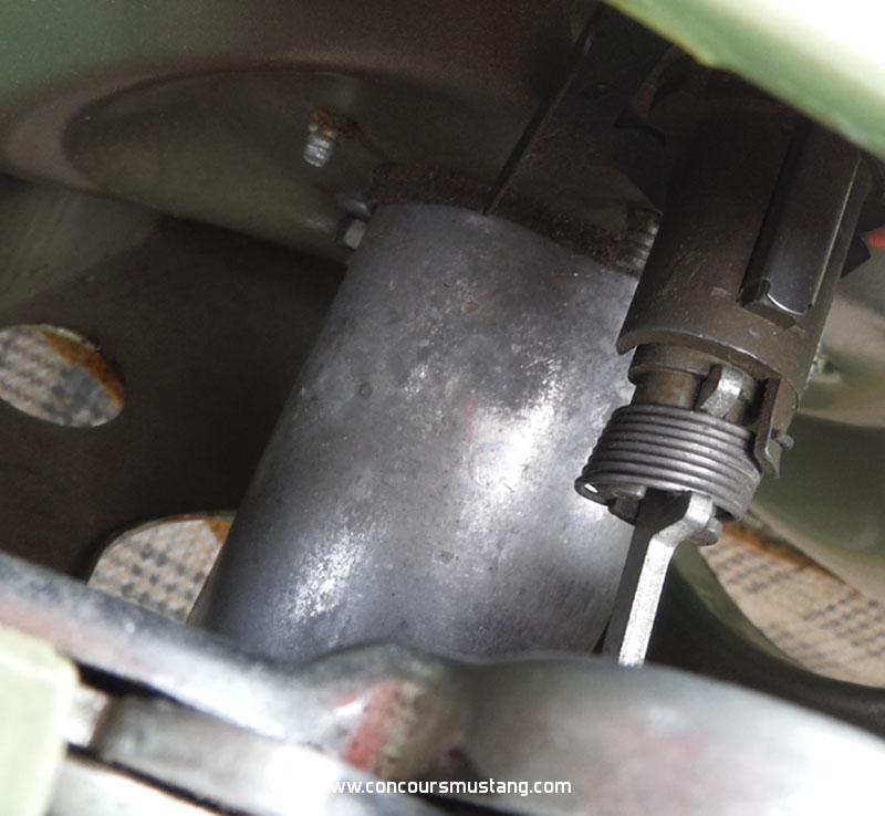

Think the four depressions in the  nut may work or deform the threads enough to have originally created some deformity and in turn a locking affect. Once removed allot of that would go away =. Just a possibility
Thought I could at least post a couple of pictures since I took the time to search.  Might help a little
7R1721xx
7R1977xx

Richard : Just FYI, both the 1967 Only, and the 1960-68 MPC's (both closer to the actual time period than the 1965-72 MPC (printed in 1975), show the same 380331--S7/8 lock nut.
However, in looking at the 1966, 1969 and 1975 Ford Standard and Utility Parts Catalogs, that part is actually the "indented type" (aka "Center-Lok") type as shown in John's picture of his used one, not the "Flex-Lok" type which came on both yours and his NOS Service Parts.
I have yet to find a listing in the MPC's for the 4 retainer screws. Interestingly, the 52064-S is only listed in AMK's book, not in any of the Standard and Utility Parts Books.
