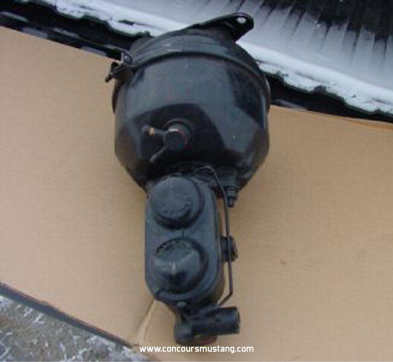

8. Inner Shock tower cover bolts (Phosphate and oil)
9. Brake booster nuts (CAD)
13. Fan spacer bolts & Washers (Phosphate)
Just a couple in the list
If you look through the unrestored pictures in that section and focus on the 68 San Jose examples you can answer some of these questions and have visual confirmation at the same time ;)
8- Try the pictures (easiest to see) in the Early 68 T code San Jose Coupe thread
9- Of course the booster nuts will be painted when you paint the booster and master cylinder assembly all together as a unit
10- You have a fan spacer??
Thanks Jeff I will check out the survivor thread. Good question on the fan spacer?? I don't have one currently, but though that I needed one for some reason, but I may be getting confused looking at the fastener spreadsheet. I will also check the MPC
So does that mean that the booster was painted on the firewall, which would explain the painted nuts. I have already painted my booster while it was off the car

Bob got the spacer/clutch one handled and there is an example in the threads I mentioned so on to the other one
No this means that the provider of the master cylinder and booster painted them together as a complete unit before they arrived at the car assembly plant ready to install Like the example below though it is for a different application. Bale on the master cylinder cap would have been closed on it also  ::)
Ah ok got it, thanks Jeff. Sorry I was referring the the other nuts & bolts that attach the booster to the firewall. I will mask off the booster and paint the rest of the assembly with the booster masked off
