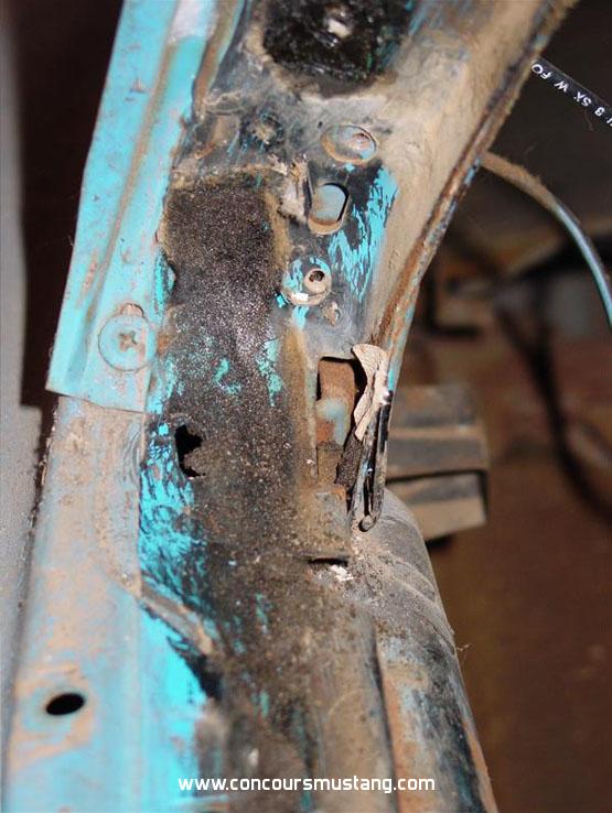

No drawings but do have one picture.  Brian

I took the roof rails off of the race car (65 2+2). I believe they are built in a similar manner.
The roof is actually welded to the inner structure that surrounds the window/door opening.
Your visors attach to this structure in the front.
The roof rail is then welded to the underside of that combined structure.
As the roof rail moves toward the vent window it stopped and becomes a separate piece.
I happened to have a cross section of the roof on the flat just beyond the vent window. Zoom in.
« Last Edit: March 20, 2020, 04:48:25 PM by J_Speegle »
Thanks Brian!!! Do you happen to have that same picture, except aimed a little but north, towards where the roof, quarter and these drip rail pieces all come together?

Offline Brian Conway
  • Posts: 1623
One more picture of that area and no others.  Brian

Thanks Brian!

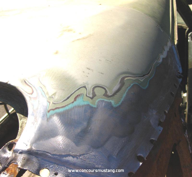

Here is an example of the lip of an original roof panel where it would joined to the quarter panel - 69 example Have a few more but this is the clearest showing the lip formed leaving room for the quarter panel edge over/relief for the roof. Was using this as a suggestion of the order of assembly and have seen shops replace panels in a number of different orders.  Just human and still learning just about every day something new.
Guess if the order was roof last then they could have slipped the roof under the quarter panel.  Early weld and sealant manuals do show the outer layers (driver and passenger) being assembled as sub assemblies before adding them to the main unibody but don't know if this continued into later years so if they followed the same pattern your order (quarter panels (with the fairly complete side of the uni-body)  followed by the drip rail and after the roof would be correct.

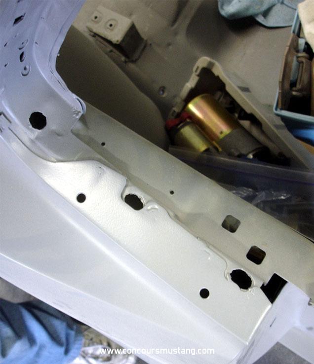

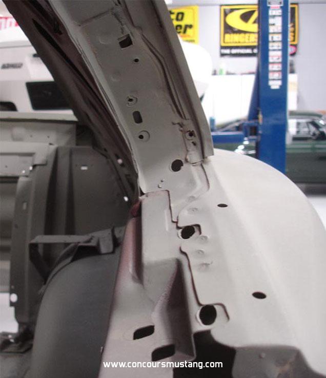

Here are some examples from a 69 I was able to find  Hope it helps

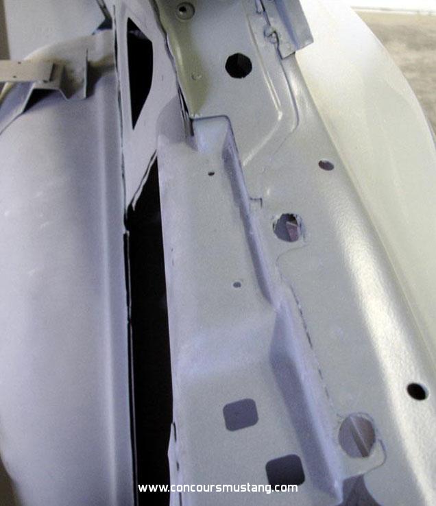

Only one I found find in the collection for a 70 example. Apparently not may others thought of taking pictures of the areas either

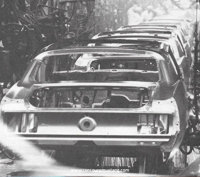

Last of this part of the discussion I would expect - Did go back through my pictures and did find this picture of 69 production with the unibodys with quarter panels, drip rails but no roofs yet

Wow, very helpful Jeff - THANKS! Much appreciated.
Am I interpreting your pics of the quarter panels correctly?.... it looks like the short drip rail pieces are welded onto the body, even though there are three screws used as well. What's the purpose of the three screws, if these pieces were welded? Do you suspect this is something that varied from plant to plant?

I found those small drip rail pieces to be screwed on with sealant sealing it to the body. As they go on last you are able to fine-tune their position so the boomerangs sit properly and look right.
