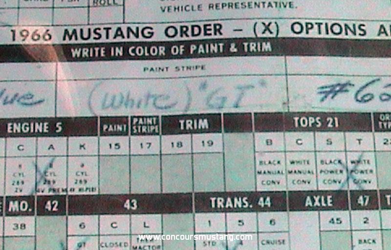

I saw the blue top option on a 1966 Ford passenger vehicle order card.  Blue power with plastic glass was code Y and Blue with glass was code 5.
Re: Convertible Top Color
« Reply #9 on: March 23, 2020, 09:54:35 PM »
Believe you may be looking at the passenger car order card or form.  Looking at a punch card there is no separate section for each body style or model though enter would only be what was available  and what is shown on the card had to represent all models in the Ford line. Blue was apparently available on something like full size Fords and maybe Fairlanes
Here is the convertible top section of a 66 Mustang order form

« Reply #11 on: March 24, 2020, 03:26:41 AM »
Just so as not to leave you "hanging", for 1966, the Full Size Fords, Fairlanes and T-Birds offered a Blue Top, but the Mustangs only Black or White. Attached is from the Soft Trim Section of the 1960-68 MPC.
