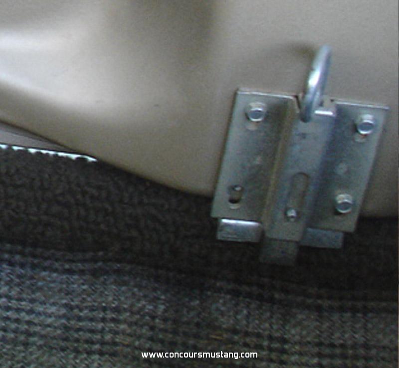

Looking to confirm the finish on these 2 rear trap door parts.
The handle appears natural, but could have been phosphated.
The lock appears to be zinc plated
« Last Edit: March 30, 2020, 12:54:07 AM by bullitt68 »

The lock is zinc plated and the handle is typically a medium shade phosphate .
Thanks Bob appreciate it. Thanks for confirming

Pictures of unrestored San Jose fastbacks with the fold down option are available int he unrestored picture sections if you want examples
Check out
Mid-year 68 J Code San Jose Fastback - Unrestored Picture Thread
Missing one mounting bolt
Also associated with each is the mounting hardware were , in this case, matches the item your mounting
Mounting hardware for latch/lock is zinc and for the handle or up lock is phosphate
