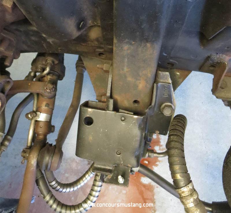

There are a number of tear  down pictures of a 70 Dearborn built CJ convertible in the Unrestored picture thread section here is a picture from that thread showing that the frame part of the mount - made up of two sections - was both black and natural
Hope this helps. May want to check out the tread for some additional details. and a few more pictures of the mounts ;)
EC-3 Frame mount for engine. Semi-gloss black with bare steel lower base brackets
