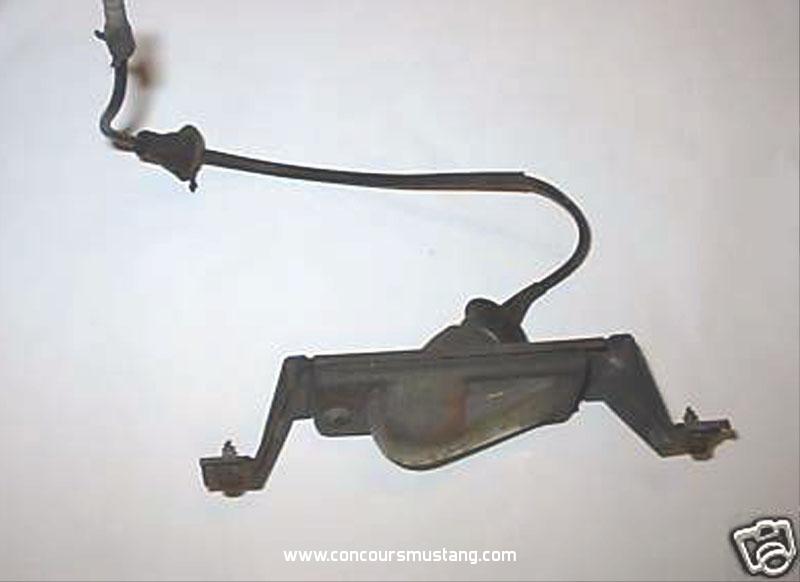

Thanks Jeff. I started cleaning up the License Plate Light Assembly and it looks original as it has a Ford Logo. Not sure what the original gasket looks like, but here is mine.
Also it looked the centre pice was dichromate and the main bracket was zinc.
Concerning shape, does my mounting end tabs (ears) look bent or is that how they came?

Both parts of the body would have been zinc dichromate As we all accept the dye does not hold up to the test of time and the elements
The "ears" would be straight across from one another ( in an imaginary straight line) the the light would sit horizontal to the attaching surface and the bumper
Something like this only allot nicer looking. Sorry not a great picture but what I have
Great thanks Jeff. That is a great start as it is the first visual reference I have. Looks like my bulb lens cover is original as well, not sure about my gasket. Looks like I will need top try to find a new wire as someone cut mine at some point.
