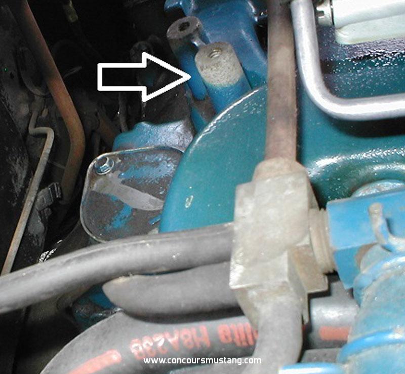

- Borrowed from another posting but an example of the shadow Bob described at the back of the intake manifold. Also the painted and unpainted parts of the PCV vacuum plumbing

This picture is either a 1968 GT500 or a Cougar GT-E. The intake is the aluminum C7AE-F casting with the blank off plate at the rear for use of the intake on earlier vehicles with either a road draft tube or PCV system plumbed in that hole.
