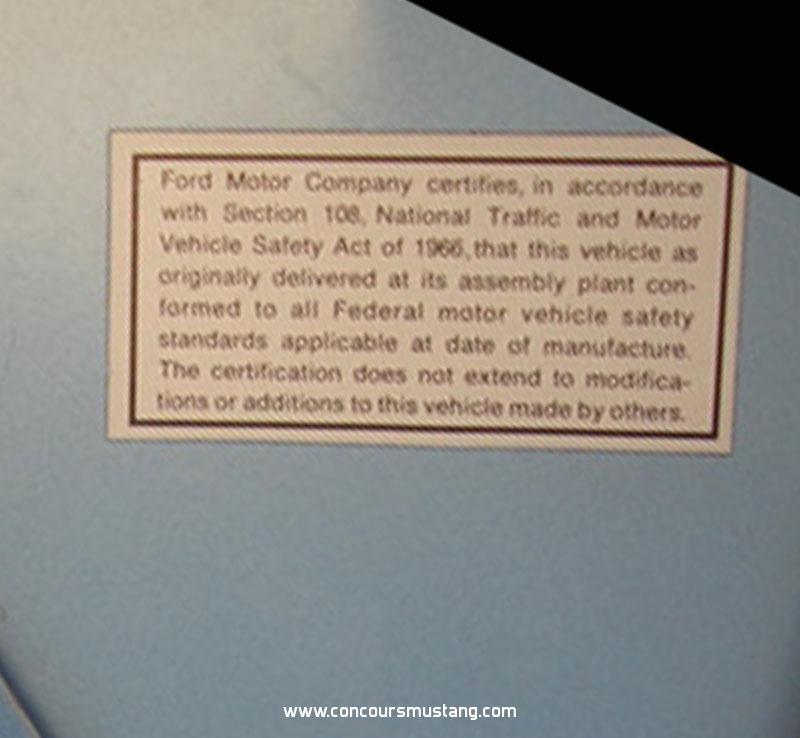

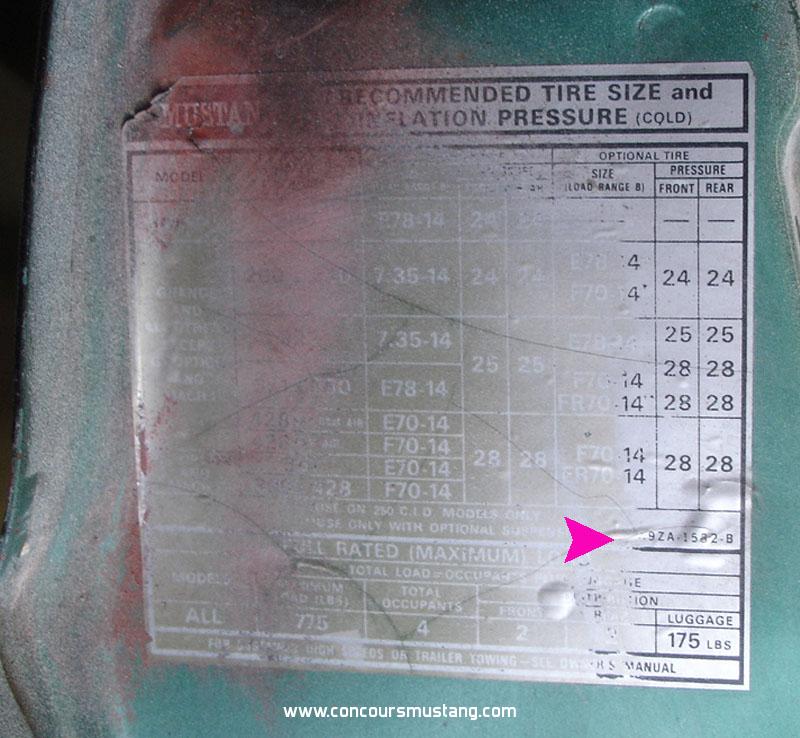

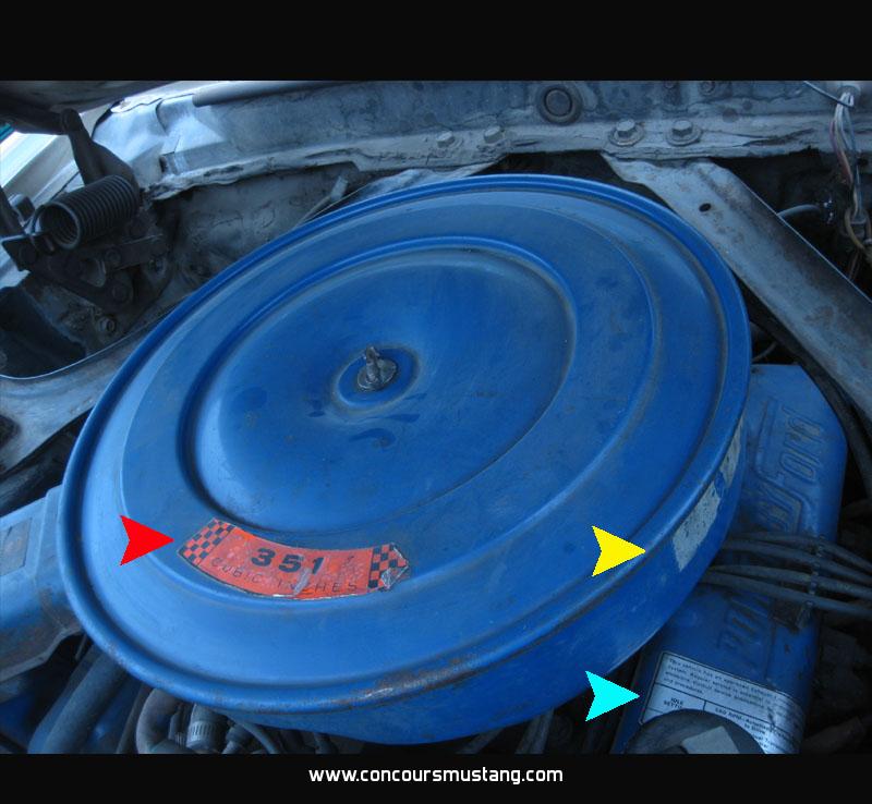

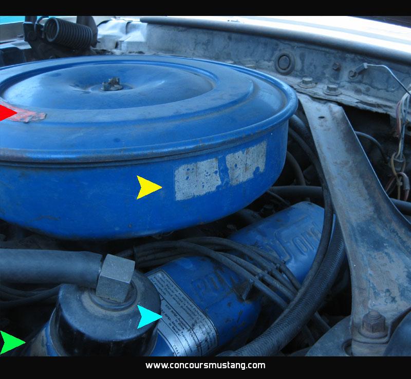

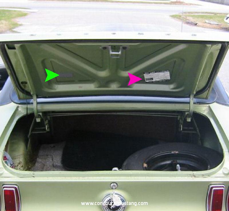

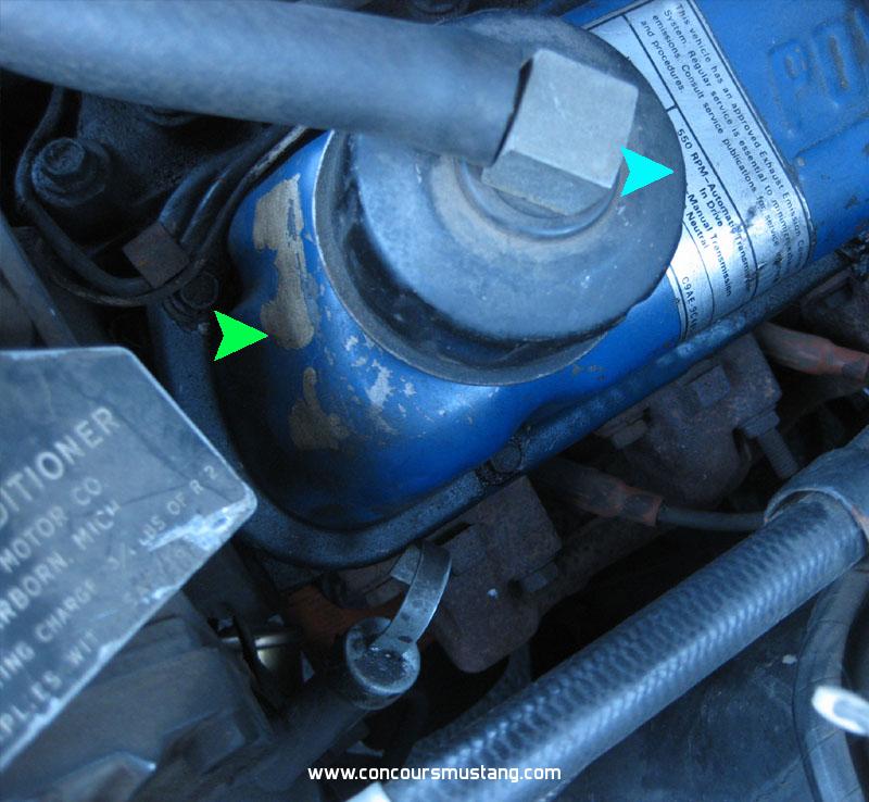

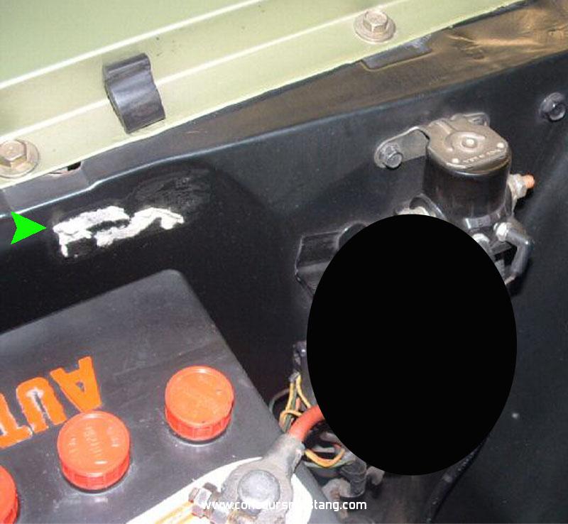

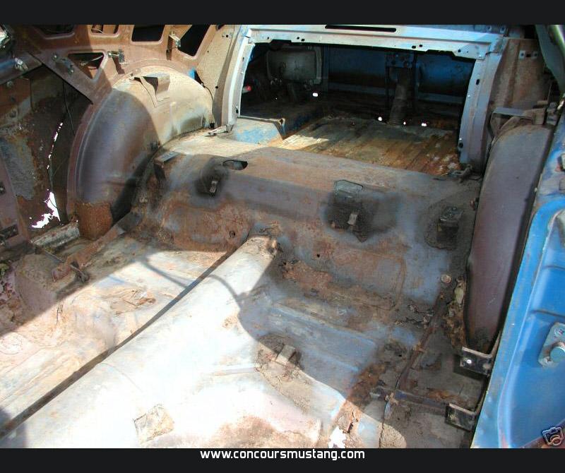

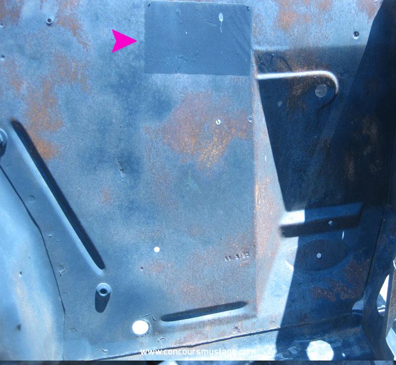

Hope this helps. Focused on the cars/examples with projected and real build dates during Nov 1968
Battery inspection location
Engine sticker/decal application
Red Arrow - Engine cubic inch
Yellow Arrow - Autolite replacement sticker with filter number
Blue Arrow - Emission sticker
Green Arrow - Engine ID sticker
Service Spec decal  - Drivers side inner fender panel
Tire pressure sticker - Drivers side door. C9ZA -B version

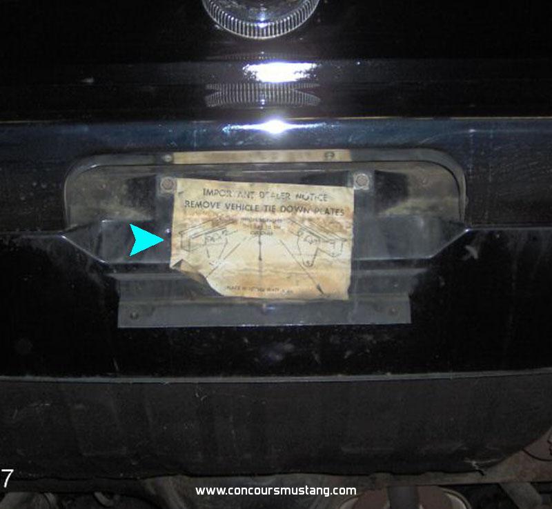

Trunk stickers
Purple Arrow - Jack instructions
Green Arrow - Federal Highway sticker
Shipping tie down sticker
